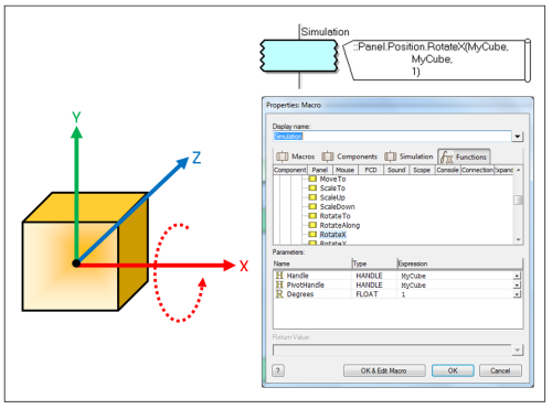

There are several api calls that deal exclusively with rotation of an object, here we are going to deal exlusively with the RotateX() api call. An object can rotate around it's own axis(x,y,z), or around the axis of another object's axis(x,y,x) if a different object is named as the pivothandle in the api call. When dealing with rotation in Flowcode it is important therefore to understand the following points
  1. Rotation of an object occurs from the centre of an object or group.
  2. The axis of the object or group may well be different from the axis on the system panel(world axis)
Rotating around an object's own axis
This is the simplest technique for rotating an object or group.The image shows a cube with it's axis labelled. Calling Rotatex(MyCube,MyCube,1) will rotate the object in one-degree steps along it's X axis as shown by the red rotation arc. To rotate the cube in a counter direction simply specify a negative number for the degrees parameter.
Examples
Calling in a calculation
  • Add to a calculation icon:
    ::Panel.Position.RotateX(handle, pivothandle, degrees)
No additional information
