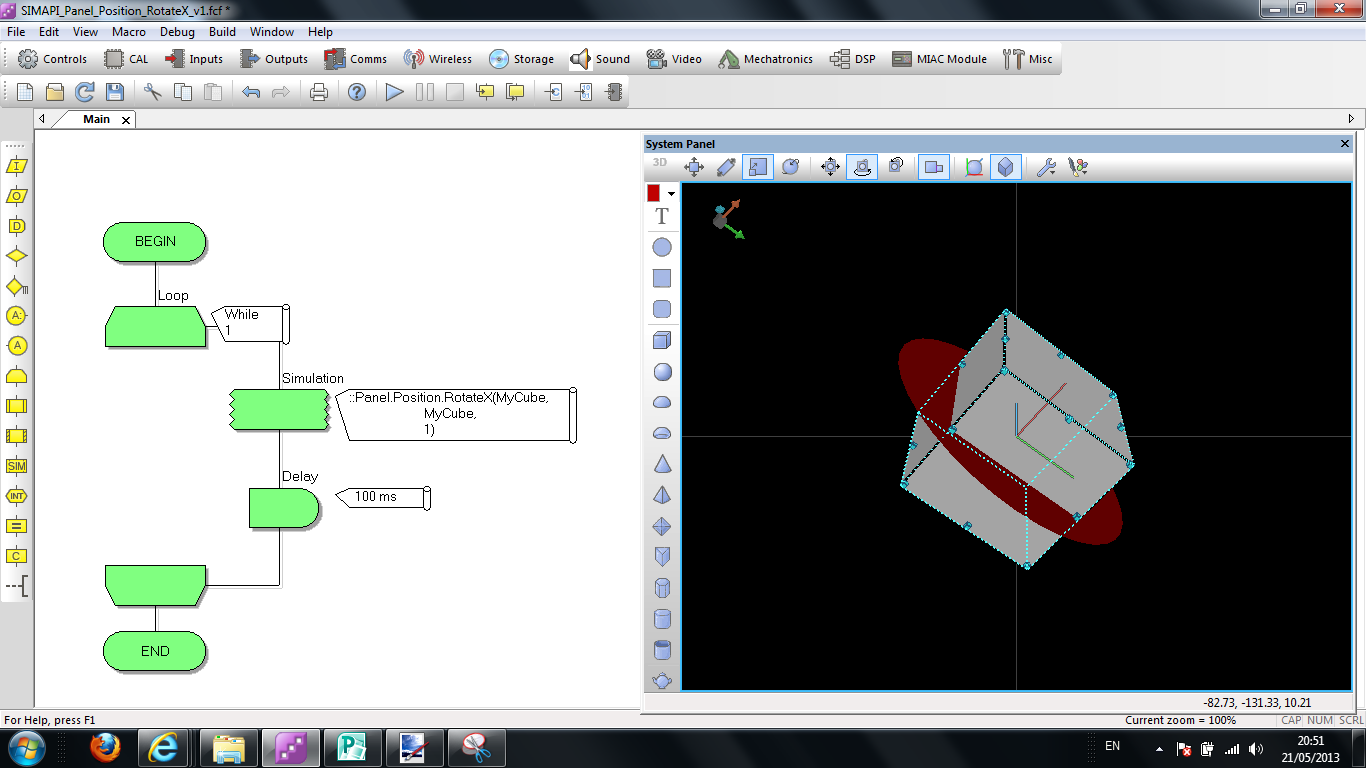

This technique is the simplest way of rotating an object or group when the type of rotation required is *not* relative to any other object or component. The image to the right shows a cube with it's axis positions identified. Note in this context the x,y,z axis is illustrated just to highlight the explanation of technique, it is not representative of the axis position in Flowcode v6. Calling the simulation api Panel.Position.RotateX(MyCube,MyCube,1) will rotate the object in one-degree steps along it's X axis as shown by the red rotation arc. To rotate the cube in a counter direction simply specify a negative number for the degrees parameter. The screenshot from Flowcode v6 below shows a cubiod with it's internal axis shown, and also a circle that cuts right through the cuboid on it's X axis (see example section below for links to the file) When the program runs the cuboid rotates along it's X axis.

This is the simplest technique for rotating an object or group. The image shows a cube with it's axis labelled (note the x,y,z axis is illustrated just to highlight this technique, it is not representative of the axis position in Flowcode v6). Calling RotateX(MyCube,MyCube,1) will rotate the object in one-degree steps along it's X axis as shown by the red rotation arc. To rotate the cube in a counter direction simply specify a negative number for the degrees parameter.
