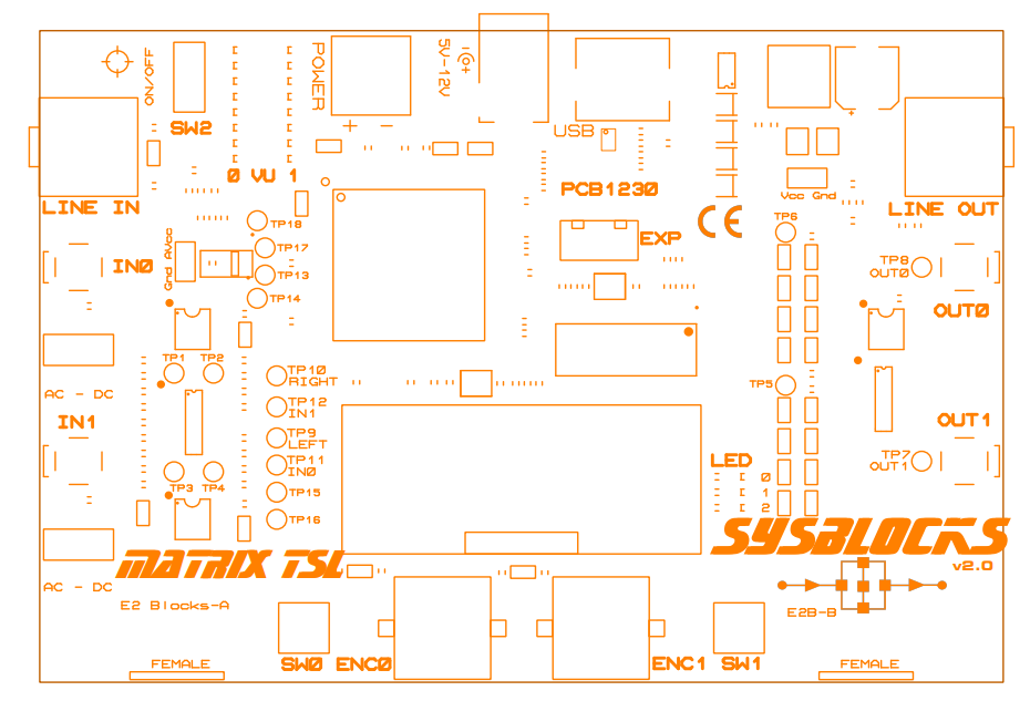

Hardware: PCB overview
1. Fast 32 bit PIC processor                                    16. Input switch SW2
2. PIC18F24K50 control processor that handles                   17. E-blocks II expansion port A
   the USB communications, 32 bit PIC programming,
   LCD display, encoders and input switches                     18. E-blocks II expansion port B
3. SMA connector  Input IN0                                     19. USB socket / power in
4. AC / DC coupling switch SW4                                  20. 2.1mm power jack, 5 - 12V
5. SMA connector  Input IN1                                     21. Screw terminal power connector (input or output)
6. AC / DC coupling switch SW3                                  22. 2 x banks of 8 user programmable  LEDs - for VU meters
7. SMA connector Output OUT0                                    23. Grove sensor expansion socket
8. SMA connector  Output OUT1
9. 3.5mm jack stereo line in
10. 3.5mm jack stereo line out
11. 4 line monochrome LCD display
12. Rotary encoder input ENC0
13. Rotary encoder input ENC1
14. Input switch SW0
15. Input switch SW1

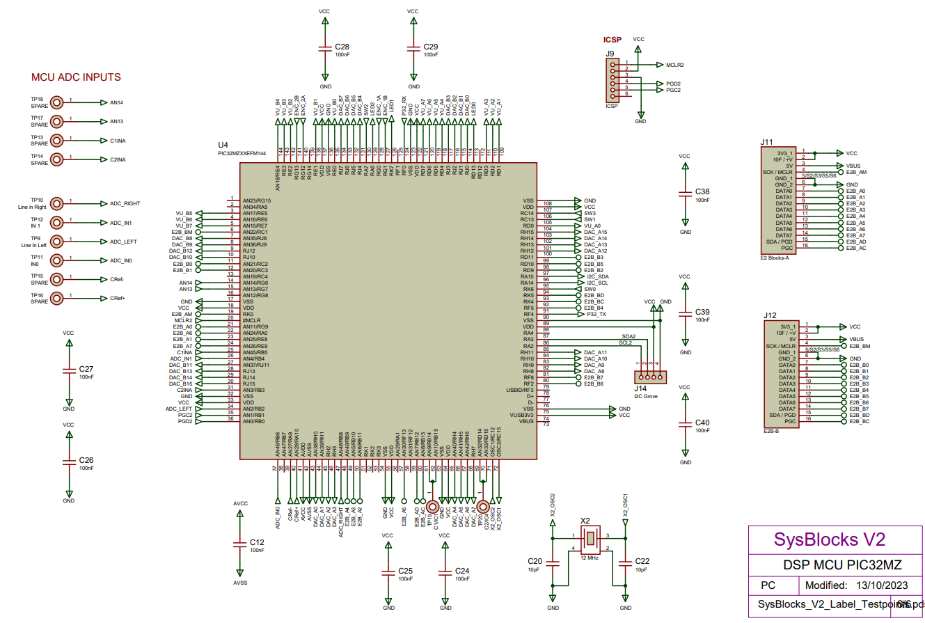

Hardware: block diagram
Sysblocks has four analogue inputs, two analogue outputs and support circuitry.

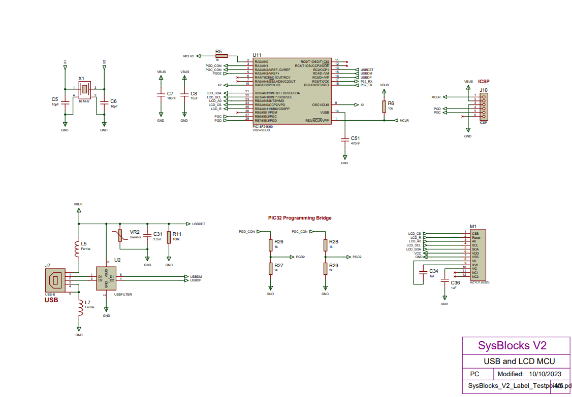

At the heart of the system is a very powerful 32 bit Micro chip PICmicro microcontroller running at 200MHz. This is capable of standard microcontroller type functions and also is capable of Digital Signal Processing the incoming audio signals. The 32 bit processor has a Coremark of 652 (around 330 Drystone MIPS) which is more than fast enough for the signal processing tasks involved for learning about Music technology, Digital Signal Processing and Modern communications theory.
The 32 bit PICmicro microcontroller is programmed by a host device which is a standard 18 series PICmicro microcontroller. This host device takes care of non-core tasks like USB communications, LCD display, encoder and switch inputs. This architecture keeps the main 32bit device free for signal processing.
Two E-blocks ports are made available for expansion. E-block boards for Wifi, keypad, Bluetooth, CAN, Zigbee and many other functions are available. This gives huge flexibility to the Sysblocks system as a wide range of projects can be built around it. A Grove connector is also available which allows users to access the wide range of Grove accessories.

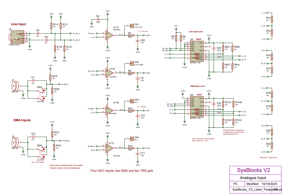

The analogue input signals are buffered and level shifted to half of the supply voltage – 1.65V – and then fed to the internal A to D converters of the main 32 bit PICmicro microcontroller. A digital potentiometer allows the level of the input signals to be adjusted in software.

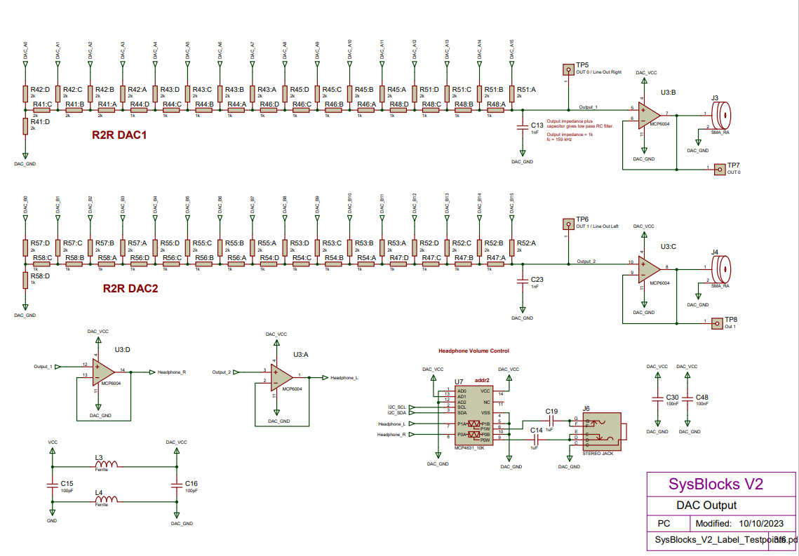

The microcontroller processes the digital signals and feeds the results to 2 x external R2R ladder DACs which are buffered by operational amplifier circuits. Line out left and right include a digital potentiometer that allows the output level to be adjusted in software.

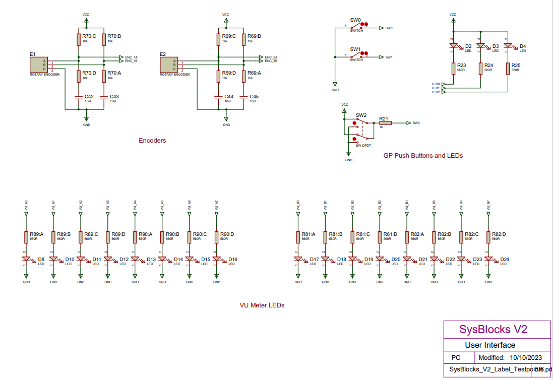

The board is fitted with a number of switches and encoders for control purposes. The board also has a miniature monochrome graphical display and a number of programmable LEDs including 2 x 8 LED VU meter LEDs.

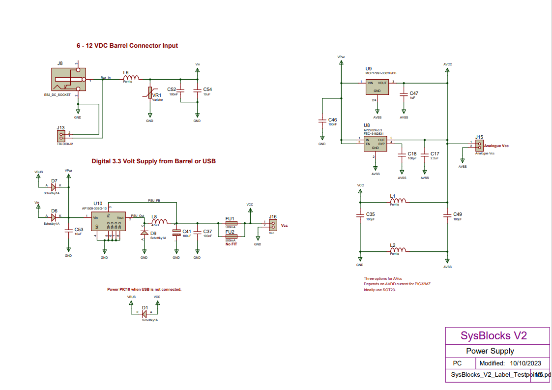

The board is powered from 3.3V from USB or from a plug top power supply.
· Vin max      2.2V pk to pk
· Vout max     2.2V pk to pk

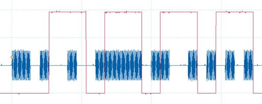

11 Evaluating the first program
For this section you will need a signal source and a two channel oscilloscope like a Picoscope. The Pico scope has a waveform generator that you can use as a signal source. You will need a splitter so that you can feed this into channel A of the scope and IN0 on the Sysblocks board. Set switch SW4 to AC You can connect OUT0 to channel B of the oscilloscope. Set the waveform generator to produce a sinewave at a frequency of 100Hz. Your Data flow program will sample this at 3kHz and will send the sampled waveform to the output. You should see this on your oscilloscope:
What you can see here is that the Sysblocks board has sampled the input (blue) and reflected it on the output (red). Now that you have the basic system up and running you are ready to start to manipulate signals.
