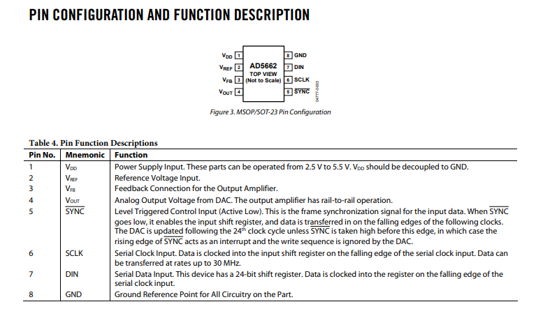

Pin reference from the datasheet:

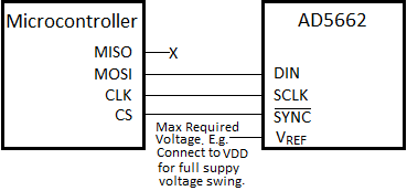

Circuit Diagram
