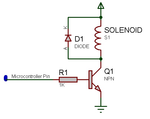

A solenoid will likely require more current than a microcontroller device can supply to activate the mechanical mechanism.
To amplify the current from the microcontroller simply use a NPN transistor or N channel FET.
The diode is required as with any inductive loads to help protect the microcontroller from back EMF generated by the inductor as the control signal switches the current through the inductor on and off
If the solenoid requires a large DC voltage, say 12V then you can connect the 12V directly to the top of the solenoid as shown above rather than using VCC or VDD. The transistor / FET will protect the micro from the large Voltage.
