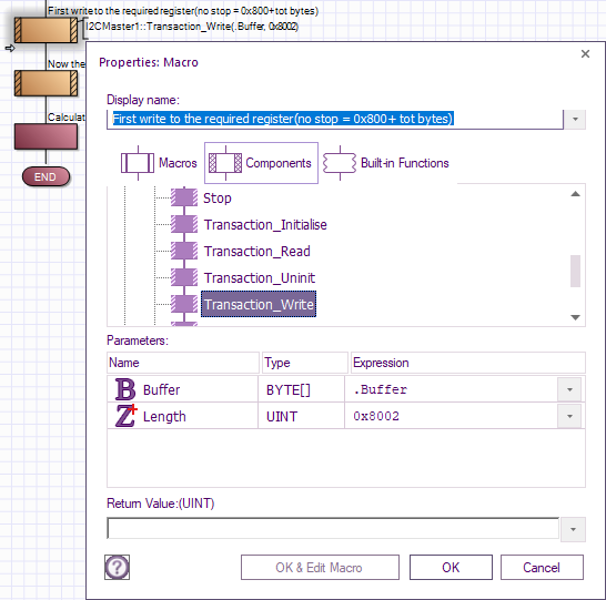

Referring to the Transaction_Write macro.
To do a restart without a stop, instead of using just the number of bytes within the Length parameter, use 0x800 + total number of bytes to read.
In the I2CEEPROM.fcfx example as 2 bytes require reading with just a restart then instead of the length of 2, a length of 0x8002 is used.
