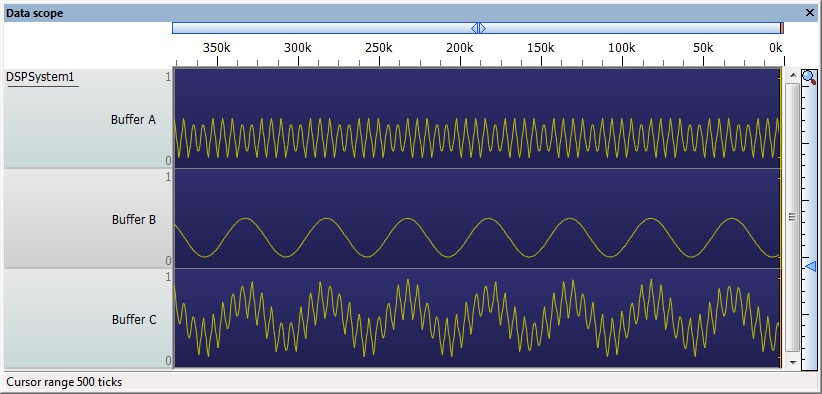

Here is a example file which generates a sine wave and a triangle wave and then uses the DSP sum component to merge together the two signals.
DSPSum
Here is the kind of waveform you can expect to see using the scope window when adding the two signals together.
Here is the kind of waveform you can expect to see using the scope window when subtracting the two readings.
Here is the kind of waveform you can expect to see using the scope window when taking the maximum of the two signals.
Here is the kind of waveform you can expect to see using the scope window when taking the minimum of the two signals.
Here is the kind of waveform you can expect to see using the scope window when taking the average between the two signals.
Here is the kind of waveform you can expect to see using the scope window when taking the difference between the two signals.
