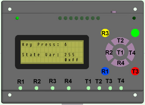

Keypad Input
Basic example of how to read the keypad and display the value on the LCD. MIAC Keypad For reference the numbering of the MIAC keypad looks like this.
