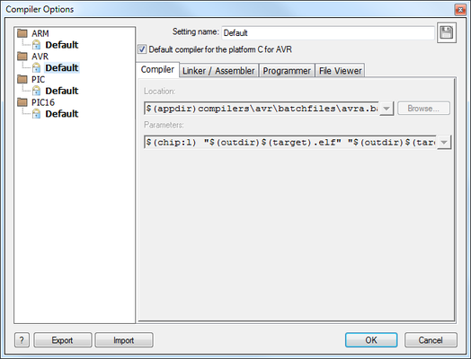

Compiler
Compiler location
Sets the location of the file controlling compilation
Default:
$(compileravr)batchfiles\avra.bat
Compiler parameters
Adds command line parameters when called from flowcode
Default:
$(chip:l) "$(outdir)$(target).elf" "$(outdir)$(target).c" "$(outdir)$(target).lst"

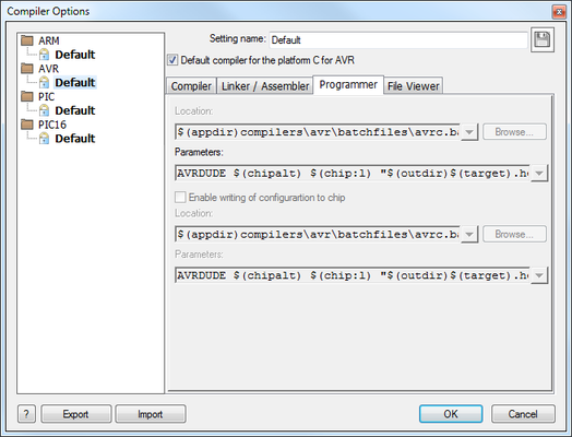

Programmer
Programmer location
Sets the location of the file controlling the programming of the target device
Default HP3006 AVR Programmer:
$(compileravr)batchfiles\avrc_usbtiny.bat
AVRISPmkII AVR Programmer:
$(compileravr)batchfiles\avrc.bat
Programmer parameters
Default:
AVRDUDE $(chipalt) $(chip:l) "$(outdir)$(target).hex" "$(target).hex" 0 $(cfg0) $(cfg1) $(cfg2) $(cfg3)
Use programmer to set configuration options
This box should be left unchecked
Configuration parameters
This box should be left empty. Configuration parameters are set and downloaded from the Build > Configure menu.
