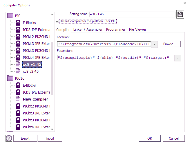

As a workaround, here are instructions of getting FC10 to work with the compiler shipped with FC7 and FC8 assuming the toolchain has been installed.
1. Extract the attached file from the zip file.
2. Browse to this location using File Explorer, it's hidden by default so just paste the link into your address bar. and add the extracted .bat file.
2. With your project loaded, select Build > Compiler Options > Compiler tab.
3. Click the Disk icon (Options Save) and change the name to something meaningful e,g xc8 v1.45 or xc8 FC8 compiler etc then click OK.
4. Select the new saved compiler name and make sure Default compiler for the platform C for Pic is ticked.
5. Select Browse & change Executable Files (*.exe) to Batch Files (*.bat) then again paste in the address bar. After pressing enter you should see your new pic_xc8 batch file to select.
6. Click on Open, then OK. You should now be able to compile using FC10 and xc8 v1.45
Can you let me know how you get on, please?
C:\ProgramData\MatrixTSL\FlowcodeV10\FCD\PIC\batch

If you look at the batch file within the zip file you will see it has
Looking at your msg.txt, it has
Flowcode should be accessing and not .
Another thing is I have renamed the bat file I attached from the default to
If you look at your message msg.txt file it shows Flowcode is set for the default bach file.
Within Compiler options, did you do options from 3 onwards?
Is the tick showing for the new saved name and not the default bat file?
C:\Program Files (x86)\Flowcode\Common\Compilers\pic\bin\xc8.exe"
C:\Users\user\Desktop\PingtestV10>"C:\Program Files (x86)\Flowcode\Compilers\pic\\bin\xc8-cc.exe
xc8.exe
xc8-cc.exe
pic_xc8_comp.bat
pic_xc8_v1.45_comp.bat
Re: W5500 Ethernet not working in Version 10

OK, Let's get you up and running with getting the v98 compiler to wok with v10.
I'm assuming you placed the extracted file called pic_xc8_v1.45_comp.bat
Within: C:\ProgramData\MatrixTSL\FlowcodeV10\FCD\PIC\batch\
If that is the case, when you select Build > Project options, can you take a screenshot of all of the compiler window with the Compiler tab selected and the PIC on the left showing
For example here is mine: Within the location window should be:
Unless you renamed your bat file to something different?
C:\ProgramData\MatrixTSL\FlowcodeV10\FCD\PIC\batch\pic_xc8_v1.45_comp.bat
