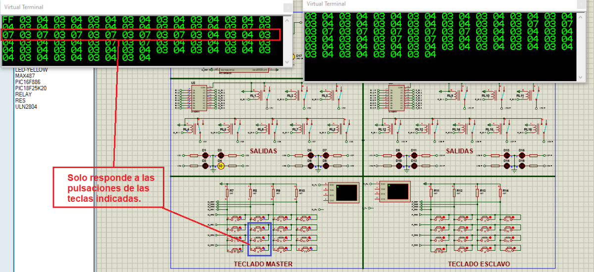

Re: RS485 example
Well, I carried out the test according to the instructions described.
If I set fixed values to the array indices, such as 14 and 75, the values that are sent and received are always correct, at least in the "virtual terminal".
However, if you change the value of index 1 and assign it the value of the key pressed, the transmitted value is no longer correct. Index 0 always transmits it well but index 1 does not (key pressed value)
It always transmits a 04 that only changes to 07 if the keys pressed are 5,8,0.
I attach a screenshot of the transmission and reception and a small example that I am implementing to see if it tells me what I may be doing wrong.
Thanks in advance for the possible answers.
