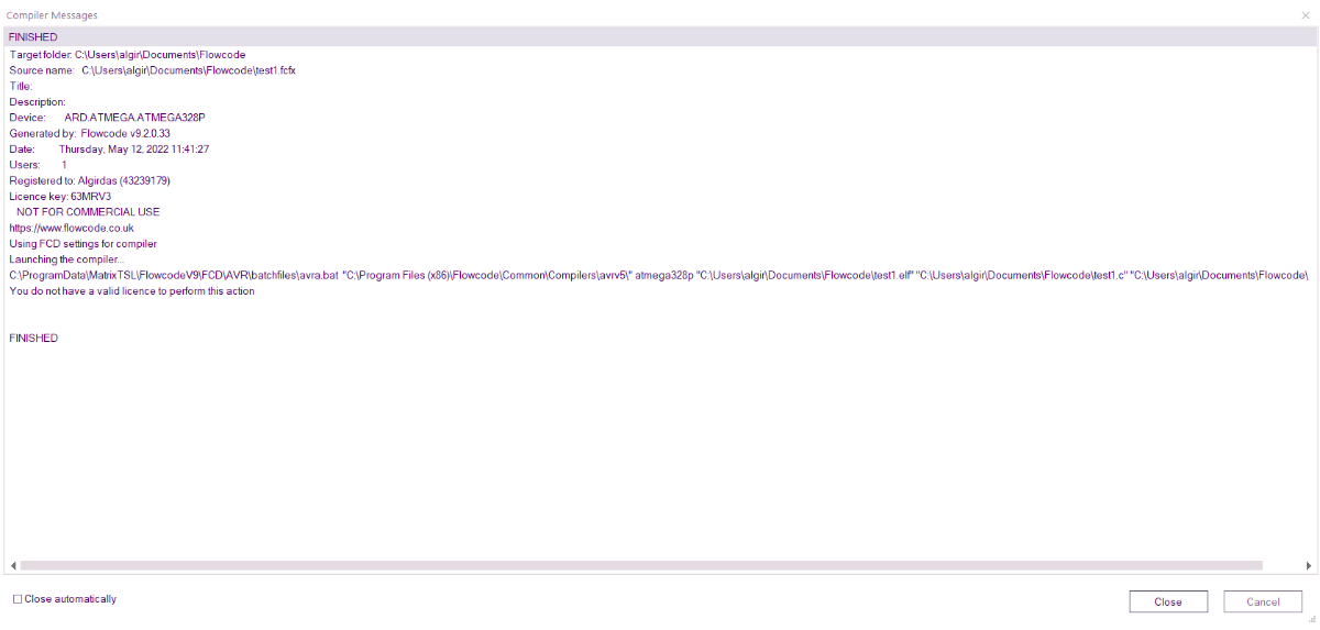

Hello everybody,
i have problems with compiler. Trying to compile file to device and getting licensing issues although I have arduino and AVR packs licensed. Any help on this? Thank you
compiler message.png (86.14 KiB) Viewed 1632 times

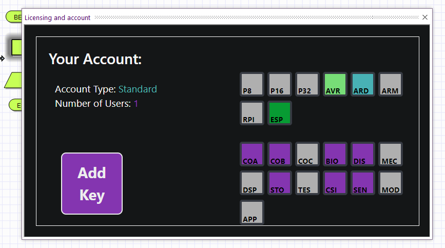

Have you logged in to accounts and selected Add Key?
After adding the key you will need to refresh your licence by running Flowcode and select help, Licensing, Manage.
Select the My Flowcode Licence icon and re-enter your details.
while in the help section of Flowocde, you can select Licensing again and View.
If there is a red X over an icon, then you are not licenced for it.
If none of this works then I will send an internal email to help you get sorted out.

after reactivating flowcode account via licensing, manage and restarted it seems that licensing problem gone. Thank you
