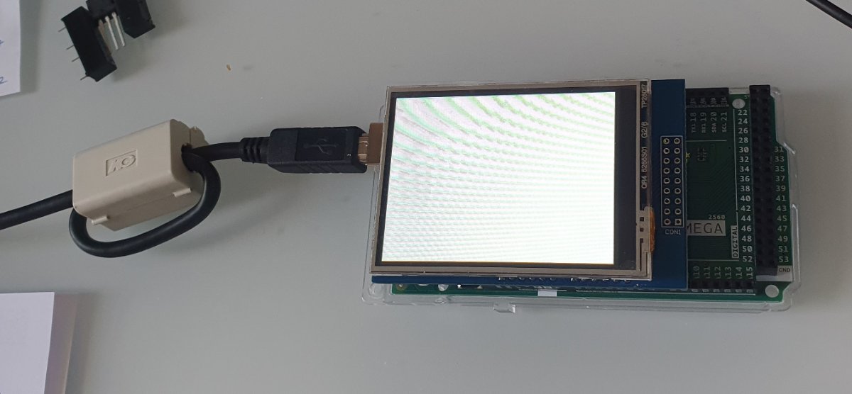

Thanks for chiming in. The display does light up, no issues with power so I assume that the basic connections are OK. There's only one way this display can be plugged into the mega because of the clever spacing of the header sections. See pic.
The project is an extremely simple attempt to get the usual "Hello World"...
Jan
Jan
