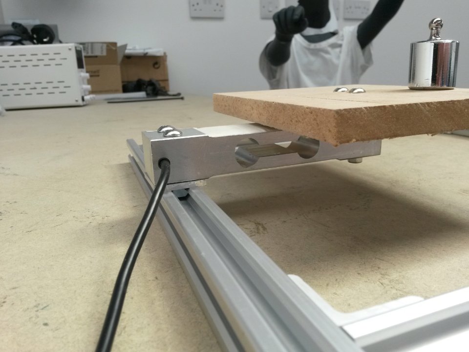

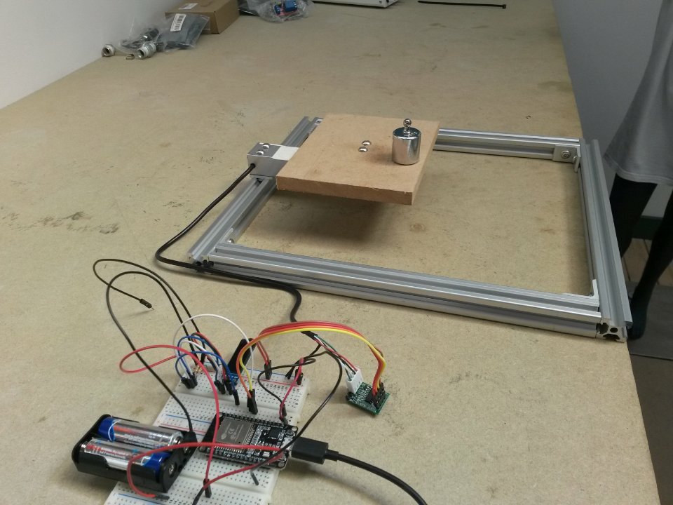

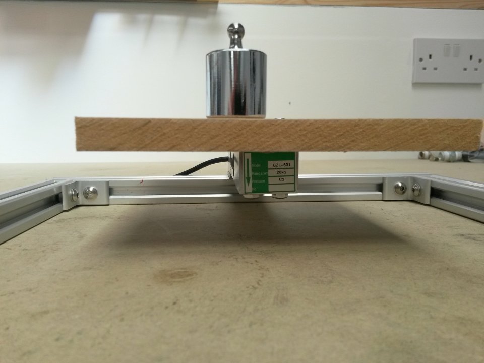

I created a small frame and did some tests up to 500g using one of the intended 20Kg cells. I was more interested seeing the stability than anything else but I have to say the results were impressive.
Sample count was set to 20/10 and it just looped around updating itself and displaying results.
The frame is quite basic and it didn't matter where on the MDF bed the weight was placed, the reading was the same.

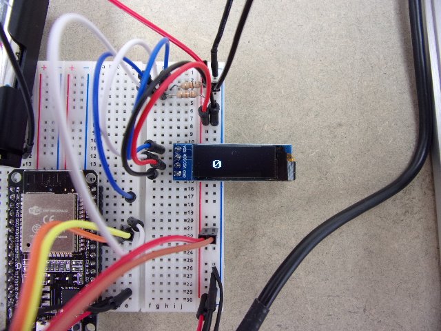

Using an ESP32 running off batteries, after zeroing I took Raw readings and shifted right >>7 to get stable readings. Temperature in the Evil Lab was a bit North of scorching (and up in my Ivory Tower it was even worse) but readings remained stable and repeatable even only being a breadboard creation.

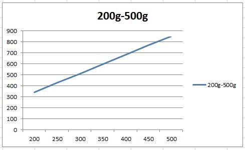

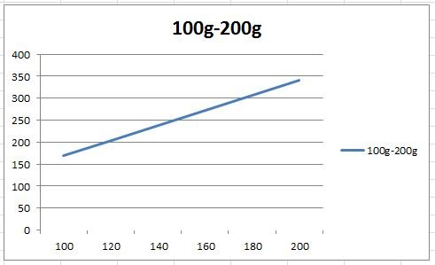

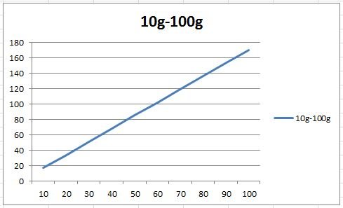

After being zeroed, I took a series of readings from 10g to 100g at 10g intervals. This provided linear results as can be seen in the graph(s). A 10g weight gave a value of "17". I then took another set of readings from 100g to 200g at 20g intervals. Again results were linear. Finally I took readings from 200g to 500g at 50g intervals. Every result was a multiple of 17.
Next, I'm going to create a frame / container that is similar to the actual size in the target application and do some more tests. Hopefully the linear response will continue at an acceptable level.
