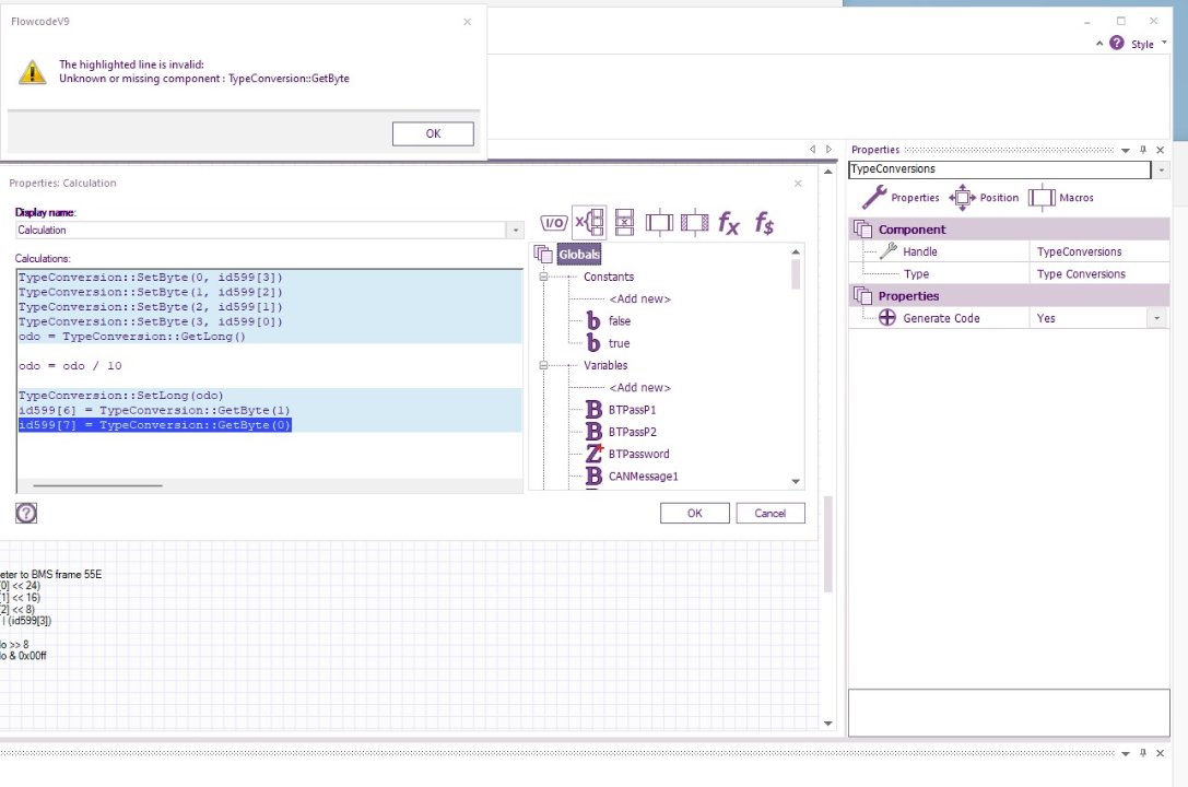

Does anyone have a suggestion for how I write this calculation in a FC calculation box
unsigned long odo = ((unsigned long)id599[0] << 24)
| ((unsigned long)id599[1] << 16)
| ((unsigned long)id599[2] << 8)
| (id599[3]);
odo /= 10;
id55E[6] = odo >> 8;
id55E[7] = odo & 0x00ff;
Posts: 1945
Has thanked: 509 times
Been thanked: 692 times
Re: Converting a program from Arduino to Flowcode help.
I would recommend using the type conversion component to do this. Should be way more efficient than doing 32-bit typecast bit shifts.
TypeConversion::SetByte(0, id599[3])
TypeConversion::SetByte(1, id599[2])
TypeConversion::SetByte(2, id599[1])
TypeConversion::SetByte(3, id599[0])
odo = TypeConversion::GetLong()
odo = odo / 10
TypeConversion::SetLong(odo)
id599[6] = TypeConversion::GetByte(1)
id599[7] = TypeConversion::GetByte(0)

Thanks Ben, I have added the TypeConversion component but get this error message in the Calculation
kennethnilsen69
Posts: 35
Joined: Wed Dec 02, 2020 11:41 am
Been thanked: 2 times
Post by kennethnilsen69 »
I figured it out Ben. I was just missing an s at the end of in TypeConversion's name
