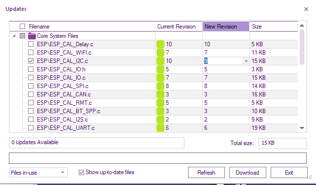

Can you please try the following as a temporary solution?
Select Help>Library Updates...
Leave the dropdown to Files in-use.
Select Show up-to-date files tick box.
Select ESP\ESP_CAL_I2C.c tick box
Change New Revision for ESP\ESP_CAL_I2C.c from 10 to 9 Select Download, then reload your project and compile it again.

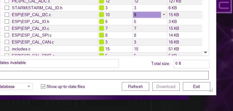

I try your suggest, but Iam not able to get 9 when I press the download nothing happen, the Download buttom is also "ghostet". not active.?
Jorgen
Jorgen

I have to tick on "filename" too, then I could downgrade to 9. And yes, I can Compile again, but the XPT2046 doesn´t work now, before this work I cant tell you of the BH1750 working, can´t go to next screen?
So far thank´s Martin Hope you can solve the rest too
EDIT ******** My fault, it´s working Martin *******
I can compile and all seem to work. Does it mean everytime I have made an update I have to go back to 9 ?
You just saved many hours work, thank´s
Jorgen
