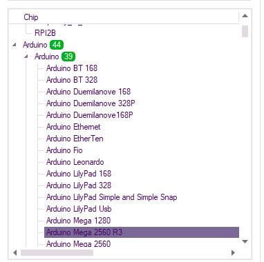

As you are using the Arduino Mega 2560 board, just select Build>Project options.
Right-click on any target and select search.
Enter mega 2560 for the search term.
Alternatively, you can just select the Mega250 from the Arduino range of devices:
Arduino Range.png (14.55 KiB) Viewed 4781 times
There will be no need to change the configuration settings as everything is preset.
Flowcode will program the Arduino board directly via USB lead.
No external programmer is required.
