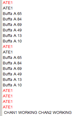

This is really giving me gray hairs I cannot get RXINT1 to trigger at all and wondering if it is a bug with flowcode in the PIC18F47K40 chip. If i send a signal to pin 5 RX1 it triggers and sends it out on TX1 pin 44, but if i send a signal to RX2 pin 7 it dose not send it out to TX1 pin 1. Both uarts are working as the sending data out as you can see in the picture. I have changed the chips many times as well but no luck Please some help will be much appreciated.

I don't have that chip to test with so I'm kind of limited in my help.
The RS232's pins on that chip can be remapped so to try and narrow things down, can you swap ch1 for ch2 so see if the problem follows? You know ch1 works on pins 5/44 and ch2 not on 7/1 so put ch1 on 7/1 and ch2 on 5/44 and see if the problem follows etc
