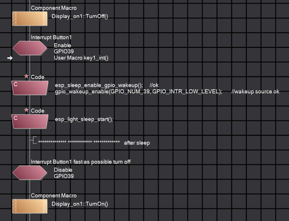

To let a ESP32 sleep i found some c-code and it's working fine
I use a button on gpio39 to wake up
Democode here:
just add this:

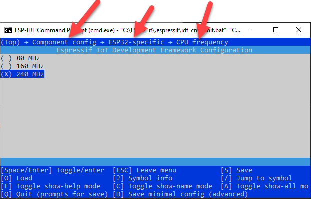

I found a way to change the clock from the ESP32.
in the menu,
component config -> ESP32-specific -> CPU frequency set to 80Mhz

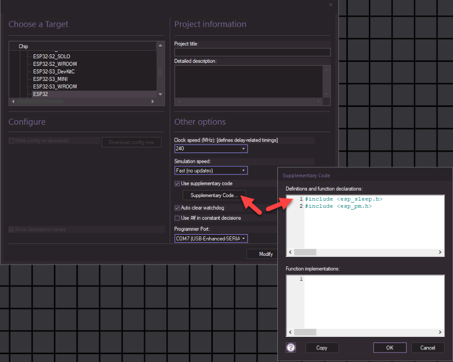

and in Flowcode in the project option set to 80Mhz.
This way I can save 20mA current and for my project it's still fast enough.
What is still missing is a wakeup with Bluetooth. Maybe someone knows how to do this.
In the setup menue:

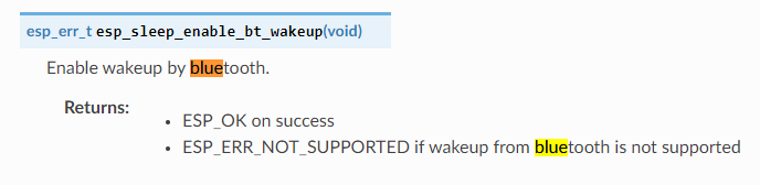

I found this site and already tried, but always i get a fail.
but sleeping and waking up with pin is working.
Am I doing something wrong in the C code?
Command in FC:
Command in PDF:

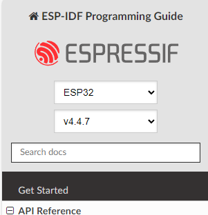

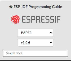

I can found if i look in V5.0.6 commands, but if i look in V4.4.7 there is no command for wakeup with BT
It's it looks like it only works from version 5 but then with version 5 Bluetooth does not work with Flowcode
