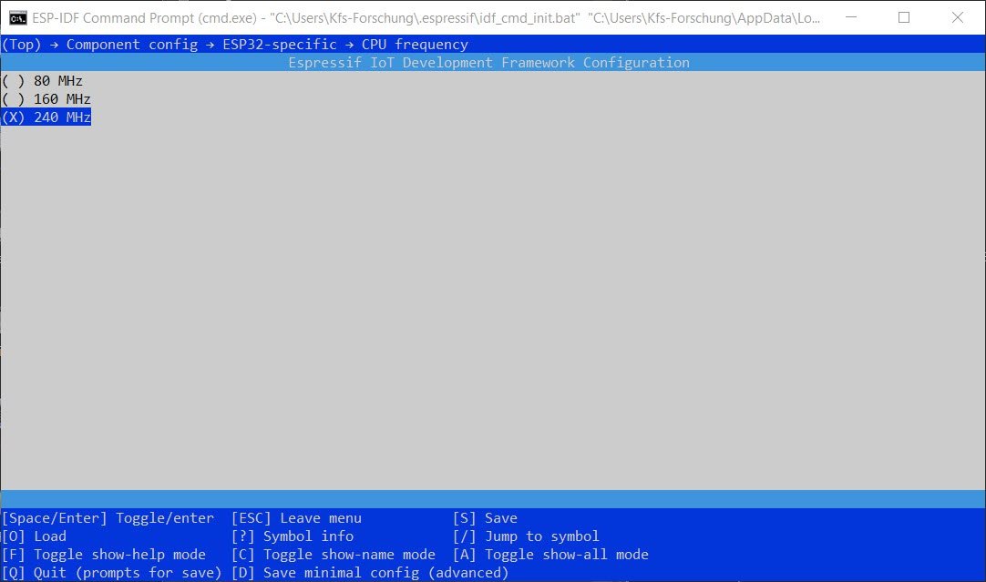

For the ESP32 it's in the config file but Flowcode has no option for 80MHz.
Info about it:

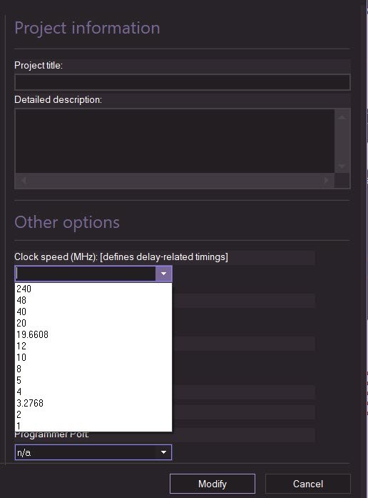

It's a combo box, you can type in your own speed

I had to enter 80 few times and then it worked.
My program needs power on 5Volt PSU as follows:
With 80MHz: normal 50-60mA, Bluetooth sending 90-100mA
With 240MHz: normal 70-90mA, Bluetooth sending 110-120mA
Comport and Bluetooth is working nice with both speed.
It's about 20% less, its something but not enough so I have to look further how can I reduce the power consumption
