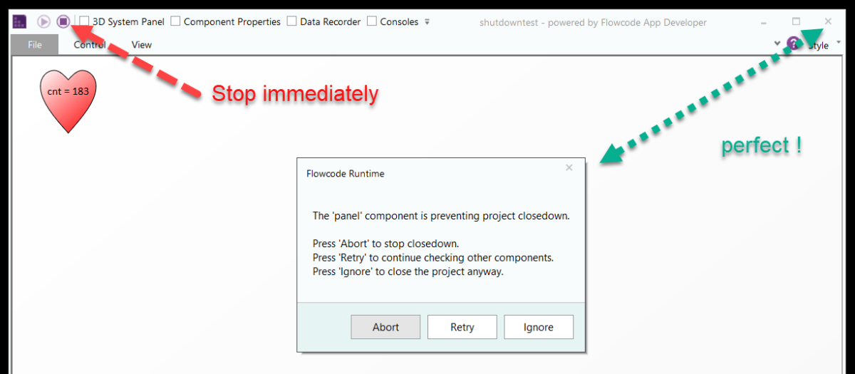

Re: App Developer Runtime close with a command
Hi Stefan,
There is no easy way to programmatically close a Flowcode App Developer app. I will add to my list to investigate.
But there is a way to prevent the app from closing (although the user can override this by pressing 'ignore' when the warning appears).
I have attached a simple app and project to show this behaviour. The Event you need is "Components.ProjectClosedown", and returning a non-zero value from this event will show the warning message.
Hi Steve
Very good !
I will use this into my programs for now.
I would like to test later when you have new commands to close the app.
Just a little remark
Unfortunately, this small square stops immediately but the user should not use this.
Very good !
Hi Stefan,
There is a Simulation Stop event that you could use to catch users clicking the stop button, In the event macro you could either restart the sim or close the app.

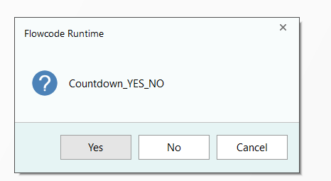

Yes, I understood a little but not completely.
The input Message window opens but the program is already closed.
Does that have something to do with the error message? I choose yes then the input Message windows open
But there is no count/down or count/up

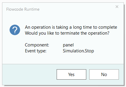

- Posts: 1940
- Has thanked: 506 times
- Been thanked: 689 times
You can't really have blocking code inside the event macro but I have edited the stop macro so that now it just starts the sim running again. Hopefully helps to avoid the user clicking that pesky stop button.
You might need to check that variable values aren't reset and if they are then you might need to store them in the stop event and restore them after.
