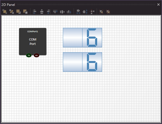

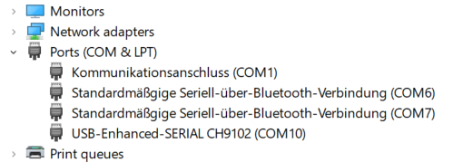

Hi Steve
There is a very good command,(scan_ for_device_ID) to detect the comport of a microchip bluetooth modul and then connect the comport. That worked pretty well.
Each bluetooth connection makes two comports, incoming and outgoing.
So far, FC has always detected the correct one, even if the wrong port (port6) appears first, it has detected the correct one (port7).
But with the ESP32 Bluetooth it only recognises the first one. So it's not working if the first is the wrong one .
Is there a way to improve this?

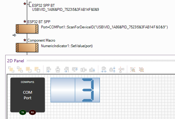

Hi Stefan,
I have had a little success and hopefully this will help you.
My ESP32 device creates only one COM port at COM3:
If I alter your project and look for this, it is correctly returning the COM port number:
My ESP32 has no program and so I have not attempted to try PC <-> ESP comms, but hopefully this gets you started.

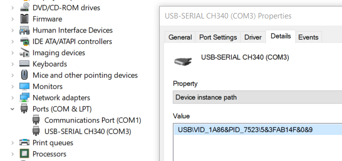

Re: App Developer Comport scan ID for ESP32 Bluetooth
You can just look for the VID/PID instead - i.e. "USB\VID_1A86&PID_7523".

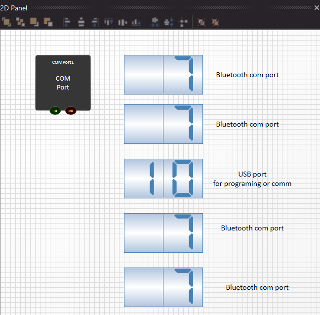

Hi Steve
I have now adjusted my program so that I can also recognise the USB port.
This port can also be used for programming (flash) or as a comport for a USB C connection with, for example, 921600 bd.
But after lunch I restarted my computer and now it reads the correct number (7).
Infos:
Infos:
