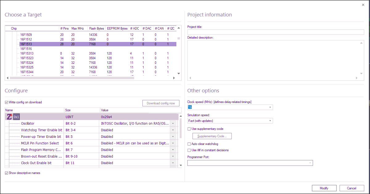

Unfortunately it didn't happen. I guess the CRC isn't the only protection.
- Snap 2023-11-30 at 08.25.19.png (149.43 KiB) Viewed 6609 times

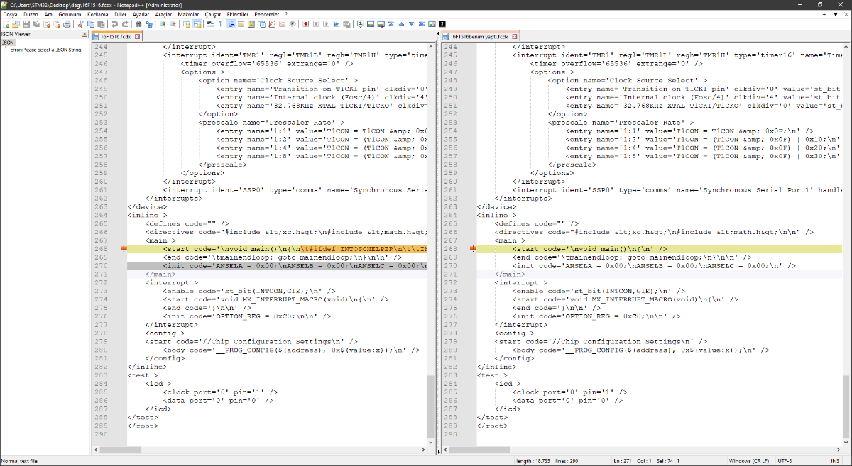

Currently the code is working properly. Thank you for your quick support.
I just noticed that the following line is different, will this cause a problem in the future?
Your Code
268: <start code='\nvoid main()\n{\n\t#ifdef INTOSCHELPER\n\t\t\tINTOSCHELPERCODE\n\t#endif\n\n\n\n' />
Original:
268: <start code='\nvoid main()\n{\n' />
Your Code
Original:
- Snap 2023-11-30 at 15.56.21.png (342.4 KiB) Viewed 6591 times

Re: PIC16F15xx Family support
You're welcome.
I have not edited that line.
The one you are comparing with is from a much older version of Flowcode.
The fcdx file I posted is for FC9.
