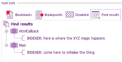

The search tool could also be useful. If you started each macro with a comment that contained a unique term for that macro or group of macros, you could quickly search for that term and use the search result to navigate to the appropriate macro. Or prefix comments with "INDEXER:" or similar and search for that. For example, your search could result in something like this:
indexer comment.png (10.64 KiB) Viewed 4791 times
The "TODO" feature works by auto-searching and listing icons that contain "TODO:" in their comments. You could co-opt this feature to navigate to important macros in a similar way (and these would be listed without needing to search for a term).
