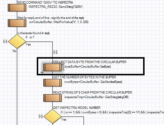

For your inspectra rs232 communications, you send out a "G00\r" string and then wait for the reply, i'm guessing the reply also contains a \r to signify the end of the reply. I have adjusted your program so that the modbus communications can happen seperatley from the RS232 communications and also adjusted the RS232 communications to try and action the reply as it comes in rather then relying on delays.

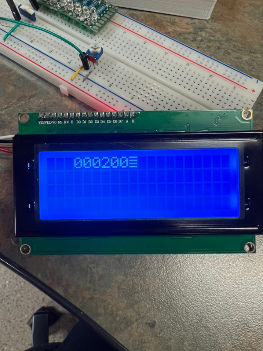

Thank you. I tried out the code. I was getting 0 in the 100 register. i used my LCD to diagnose the issue. I am getting back a string "00200E". See image below. I am supposed to get "H00200\r" I did try other strings and numbers all didn't have any issues. I can't figure out what is removing that first character when it polls the device.
- string returned

The three horizontal lines at the end of the string are the \r character.
You're code was pulling out the first byte and I kept this in in the example I posted. Just remove this icon to avoid removing the 'H' character.
