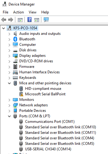

If i connect the board to my computer, sometimes it's give a startup problem and in the Device Manager add a Microsoft Serial Ball point.
Sometime it's working, sometime i have to press reset. If i start the board on a USB-C PSU it's always fine.

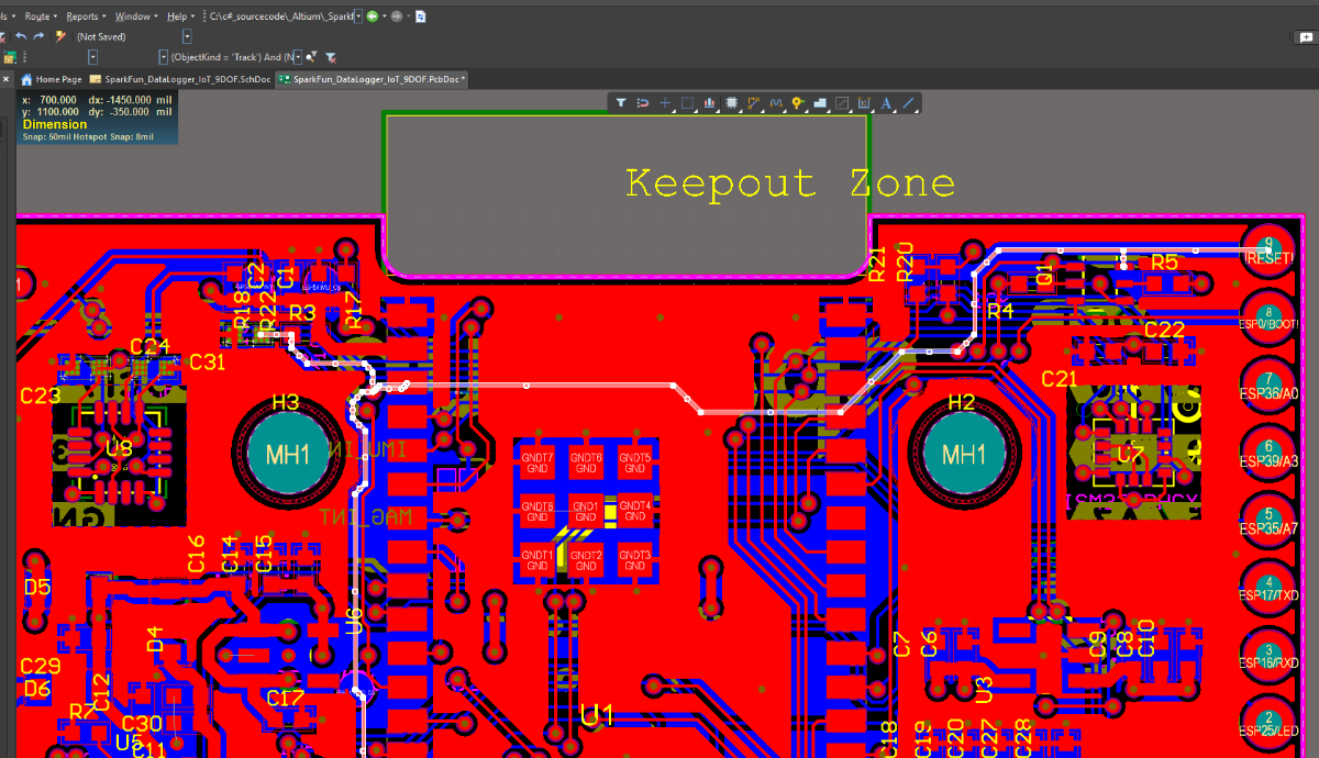

ok I will stay with this board. I can add a reset circuit. I also need to add a record and stop button (hardware). The fact that Sparkfun releases the eagle files makes it easy to draw a additional board. I will continue with the sd-cards(esp32) and ws2811 Led testing.
Nice to have the eagle files:

With a new driver for the USB Chip, the Board started always on WIN10 and WIN11 computer
Download from here:
https://wch-ic.com/downloads/CH341SER_EXE.html

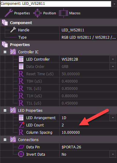

The WS2811 Led should actually work now.
A small thing is that you can select one led but the next time you start FC there are two led's again. But it still works.
Not a problem..
Download from here:
Not a problem..
