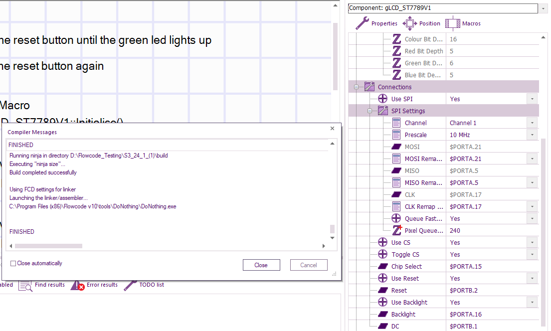

Hi Stefan,
Sorry to say the C code produced by my Flowcode is idential but the code is compiling successfully.
Is anyone else able to reproduce Stefan's compilation errors?

Re: ESP32-S3_Mini not compiling
We've replicated the issue in IDF version 4.4 but not in v5.1. As the S3 wasn't really supported in 4.4 I think this is to be expected.
Please can you send us the .msg.txt file from your IDF v5.1 compilation and we'll try and investigate further but always tricky when we can't replicate the issue.

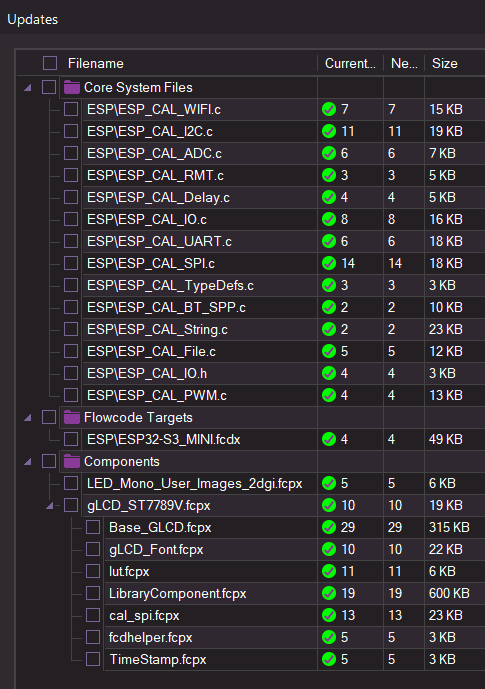

here the msg file from the notebook with IDF-5.13. Compiling is working in spi software mode but not with hardware spi
Here a list of my component.
They should all be up to date
Hi Martin
Yes, I do a full database update every time. I only have the components that appear in the project published. Maybe you can take a screen shot of your components, then we can compare we have the same version.
But on all my computers I can't compile with SPI hardware.
I also did a quick test with a C3 (just in ESP32-IDF 4.4) and there also only possible SPI in software mode.
It is good that with the ESP32 and ESP32-pico it works perfectly with hardware SPI.
