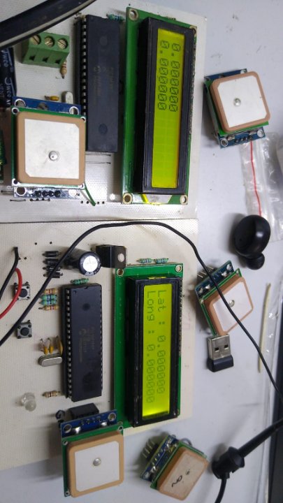

I am going to do tests with all the information obtained from you, I greatly appreciate the help you have given me, I will keep you informed; Right now I can't move from here, I'm doing what I can, with the things that I have.
Sadly I still cannot receive LAT and LONG; but I will keep trying until it is achieved and I find the fault.
Excellent video, perhaps a better antenna or an open place is required
Enrique
Best Regards !!!
Enrique
Best Regards !!!
- test1.jpg (57.72 KiB) Viewed 6670 times

Re: GPS not send LAT_LONG
WORKING GPS !!!!!
I did tests when I was in home, another common detail is that approximately 8 months ago, I worked in a place that was a large and open construction warehouse (there was a good signal there) and I didnt have any problems. Coincidentally I started doing tests a few weeks ago, but in the new workplace (with 2 roofs) one made of concrete and the other of metal structure, the place is not very large; I didn't think that the GPS reception can be affect by the structure, but in fact that affect the signal ; After days trying to achieve the sending of coordinates without success and about to leave the project, the video sent by Jorgen commented the importace of open places for the signal, as the recommendations of the rest of the Flowcode team Chipfryer27, LeighM and Martin who were helping me. Im very thankful with everyone.
Fortunaly it was a logic solution at the problem, just taked some time.
Enrique
Thanks and my Best Regards !!!
Enrique
