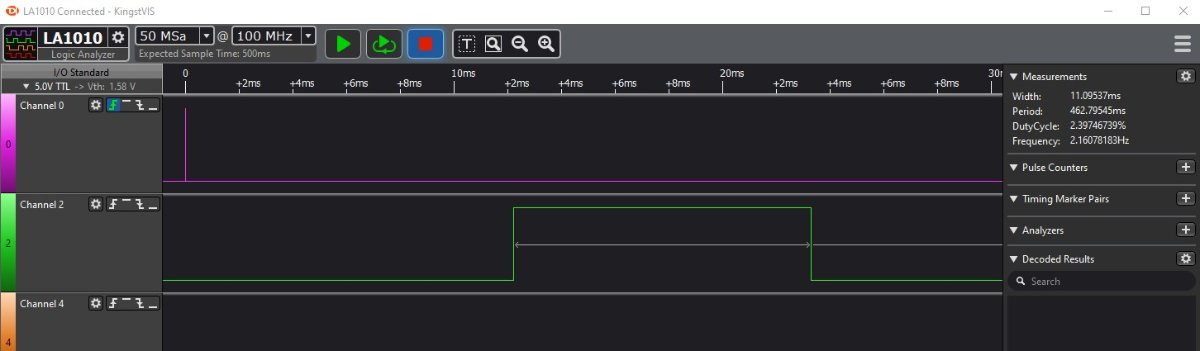

Did a couple of tests today.
Set up FC pretty much as the example file using a PIC18877 with trivial modifications to suit.

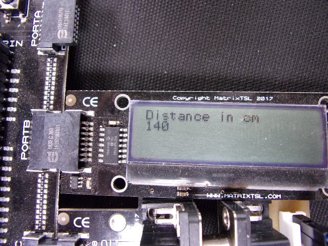

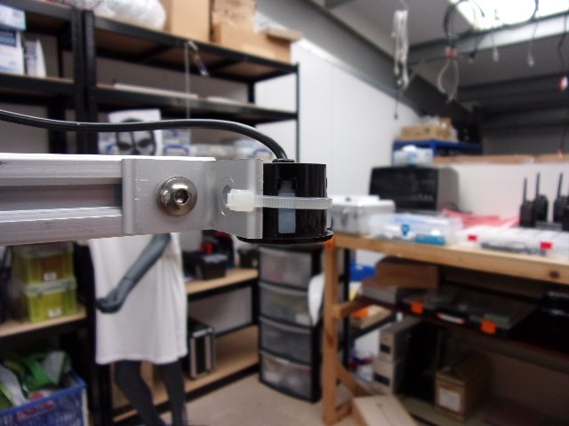

Set up a little test rig to measure distance from sensor to target. Rig holds the sensor at 90' to target, vertically, with very impressive results for such a module and my accuracy was greater than +/- 1% (bear in mind we count in cm).
These images show measured at 117 with reading of 118 (sorry, can't figure out yet how to rotate).
Reaching 140cm all was still good, reading showed nothing of concern.

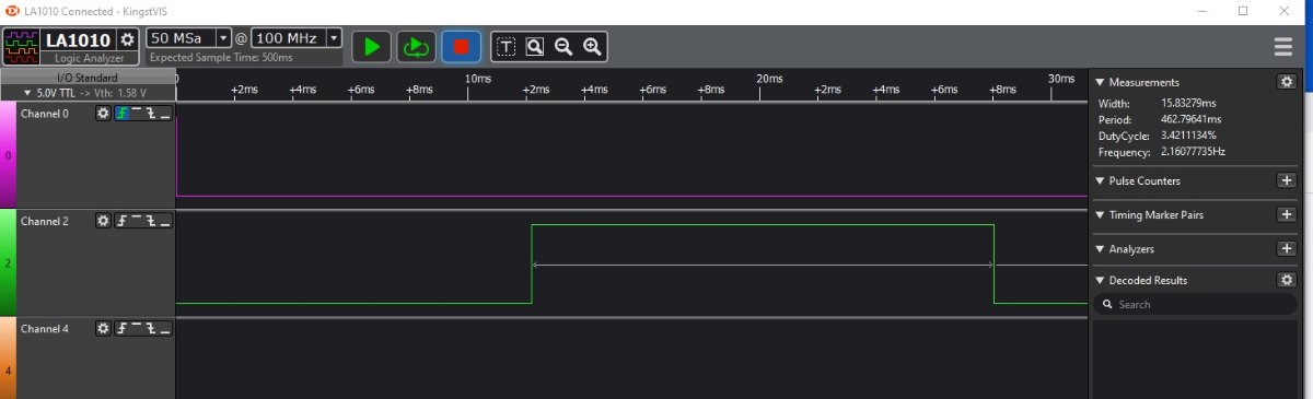

Attached are reading and pulse trace.
Now the fun begins. At anything above 140cm the readings start again at zero. At a measured 144cm the readings return 4cm. The pulse width suggests that not to be the case.
If I hold a clipboard underneath the sensor it returns the distance to target, but once above 140 it starts again from zero.
This pulse is at 190cm with reading showing 50cm
This is measured at approx 270cm. Reading shows 132 (if you add in 140 then it's still with +/- 1%)
I'm guessing some variable within FC has rolled over or the like.

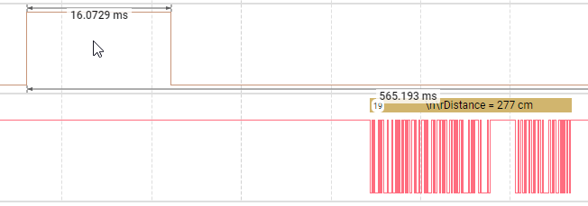

I have just tried the sensor at greater distances.
Results for 277cm:
SR04 Sensor1.png (13.95 KiB) Viewed 7345 times
I have noticed that reflections on nearby objects affects the reading the great the distance which is expected.
I.e. the further the object the wider the band.
What I would recommend is do what did, also have UART output that states the distance so both distance reading and pulse width can be matched together.

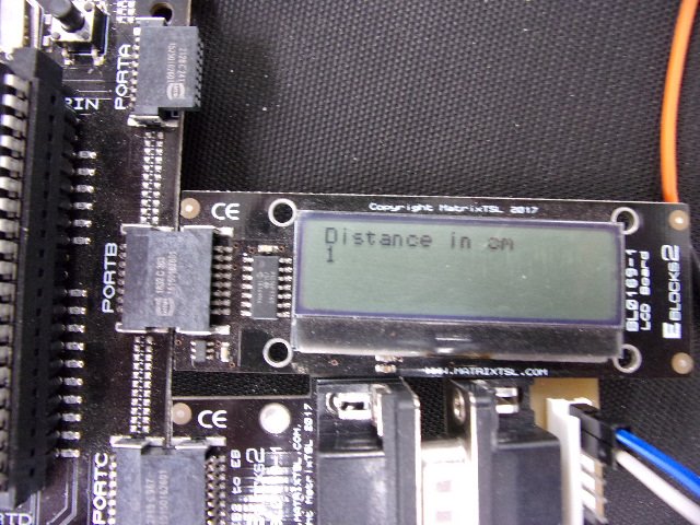

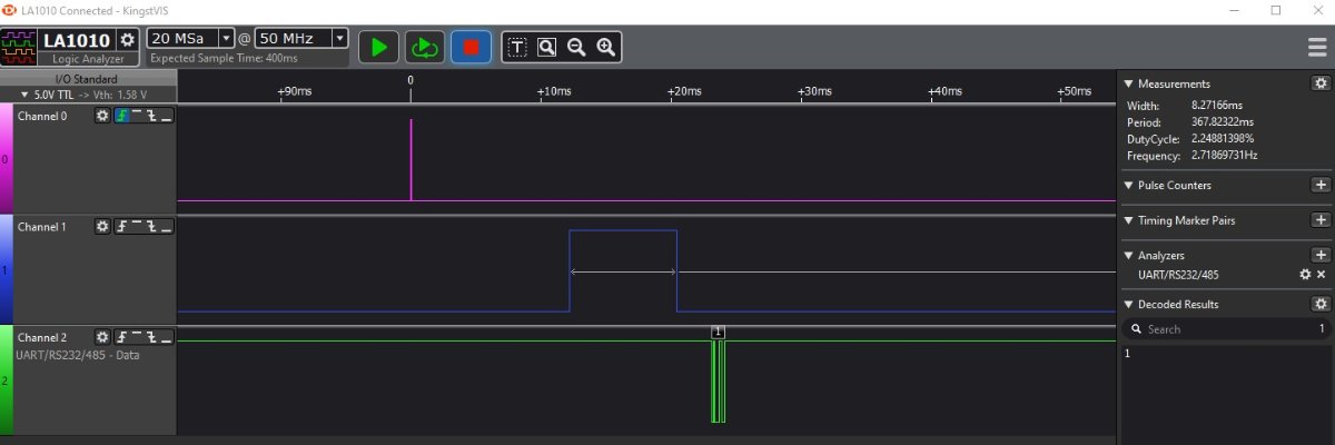

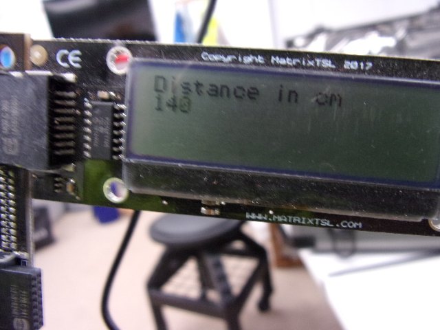

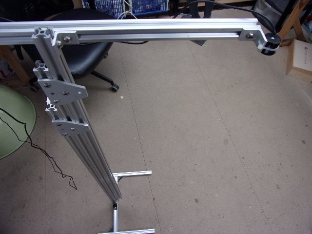

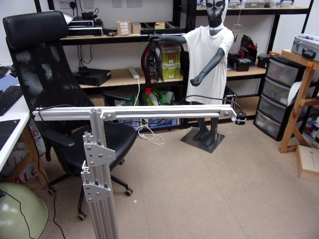

Picture of test rig with sensor pointing to floor. This reads 114cm on display / UART with pulse width of 6.628mS

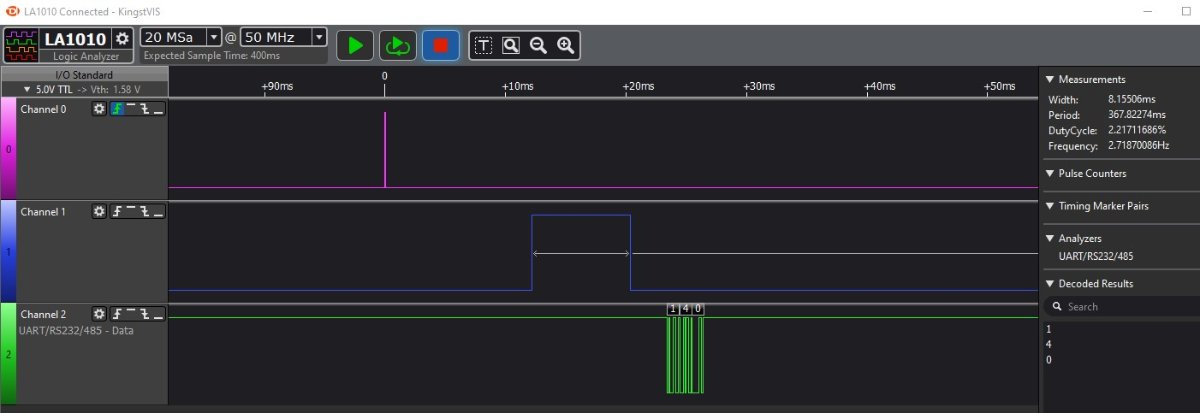

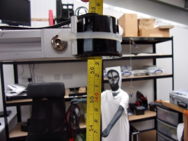

Next is at 140cm with a pulse width of 8.15506mS

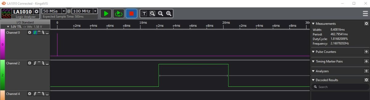

Now we read 1cm with a pulse width of 8.27166mS

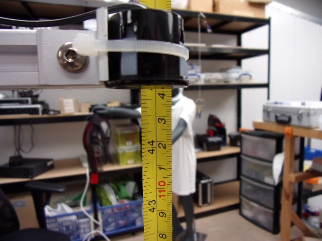

The tape measure is only added when I physically measure the distance, nothing else in near enough to interfere, you can see there is nothing 1cm below sensor and pulse width has increased, not decreased.

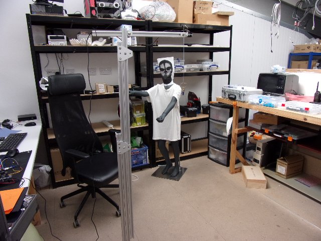

That's my "Ivory Tower" up in the clouds, i.e. the mezzanine floor I built to elevate my status :)
Scopes / analysers / soldering / test equipment / anti-static work areas and general benches all live up there with me whilst below I have CNC / milling / lathes / bandsaw / metal-bending and all other stuff you'd expect.
I do a lot of Proof-of-Concept and prototyping, but could also undertake small productiion runs if required.
I got the TRS-80 running but struggeled to find a use. I did think on building a generic interface that could plug into the expansion port but then thought "why" as even a modest PIC would outperform, so I'm still looking for a project to use it with.
My zombie used to be a minion but it displeased me so now it is undead. This came in handy as I needed help to test a sensor I was using as part of safety feature on a gun that would travel at speed. Before setting off it would check that nothing was present in the path and if anything did then appear it would come to a halt. I needed a human size target and also a "hand" to check it did come to a halt without endangering me :)
