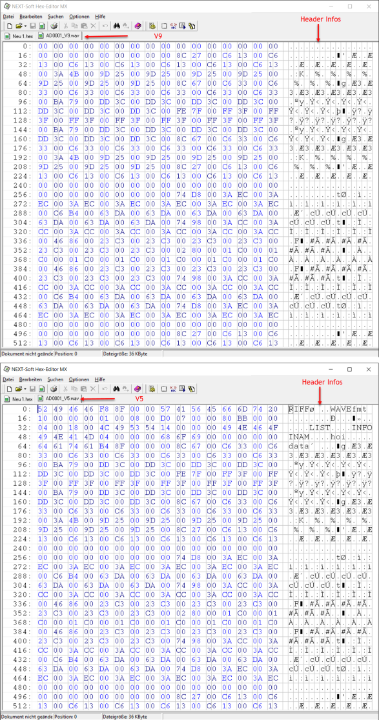

Embedded FAT is working nice on the micro SD Card. No problem.
But the update from FATSCADA (App Developer) higher than V5 gives a problem with the header attached on the end of the recording.
It's just writing 00 00 00 instead of Fileheader Infos.
There is no need to rush, I can work well with FATSCADA V5.
