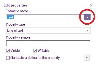

Hi Matrix team,

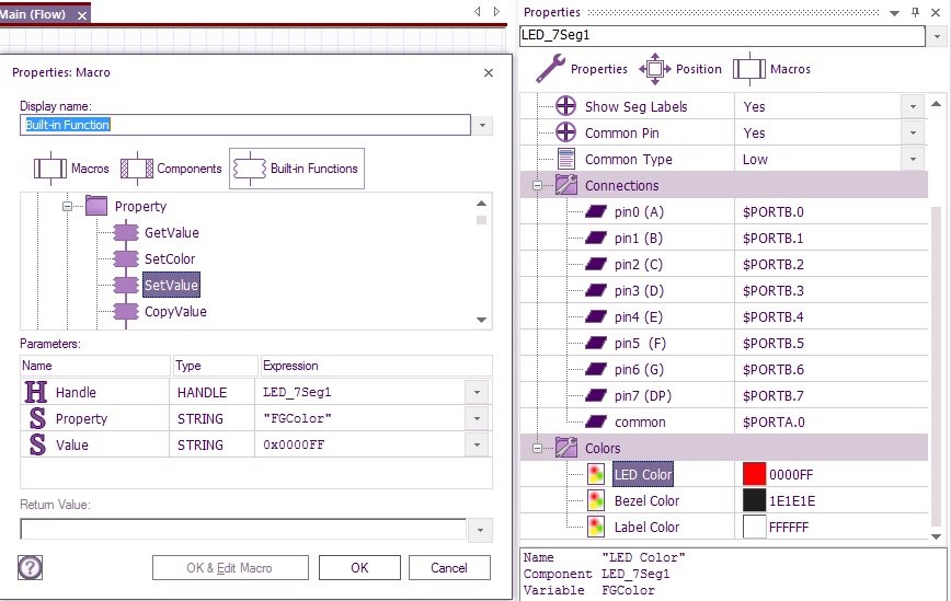

How can you do tool tips? Can you change the colour of the seven segment display with a veriable so you can change in the code.

For tooltips, you could create an invisible object with text. When you want the tooltip to show, position it correctly and set the text appropriately, then make it visible.
For the 7seg colour, you may be able to use the SetValue built-in property function to directly modify the colour that you want to change. You will need to do this for each individual segment.

Hi Wayne,
Tooltips for properties can be added by clicking in the drop down here inside the edit property window.
As for changing the value of a propety, this is done by clicking on the property you want to change to get the property variable at the bottom of the property window.
Then as Steve says use the Component.Property.SetValue function to set the RGB value of the property.
