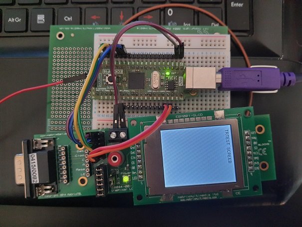

Now compiles but still appear to have problem
I have connected a digital scope to the outputs and an EB001 as dsplay is not showing any text
The scope indicates that the chipselect (CS) is not changing
Can you check again (Note i have the EBM001 pluged into a eb084 board)
Note also not actually using the rest or LED OUTPUTS in this test application
Note in the program also using EB086 and that works fine on SPI and its CS does change
Have included the program etc
David

Re: EBM001 does mot compile
Hi David,
For your print function you are setting the font parameter to 2, this should be 0 as you only have one font defined for the display. If you want to scale up the font as done in previous versions then use the SetFontScaler function to set the print size.
The CS pin I beleive is pulled low and kept there to speed up the display output.
Connecting up as per your connections it seems to be working ok for me.
Have you got the latest component updates by clicking Help -> Check for updates?
Note if you are wiring up like me then you need to wire into the Left hand side of the DIL header.

Thanks for quick reply now working fine
