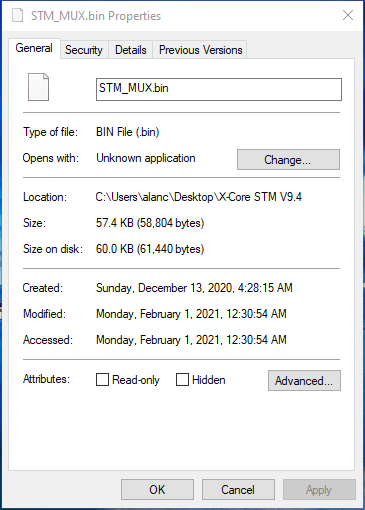

- but then I found out that because the STM compiler also produces the bin file was much easier to just look
at the bin file size but ok at least I could verify that the tool works well as you can see from the properties
of the bin file below
