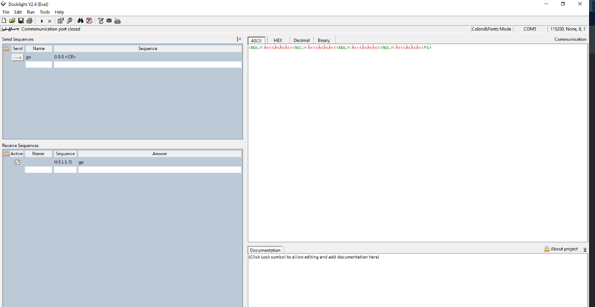

I am using the Arduino chipset. I have provided my code as an attachment. I am attempting to send "HELLO\n" over UART from the ATMEGA2560 H0,H1,GND (channel 3)pins to docklight. I am connecting to the desktop with a rs232 to usb(PL-2303), null modem, and DB9 breakout connector. I also tried connecting with a RS232 Shield. I have tried with different baud rates and no luck. I use 1 start, 1 stop, no parity. Any suggestions?
I attached a pic of what I get if I try sending "HELLO\n" to docklight.

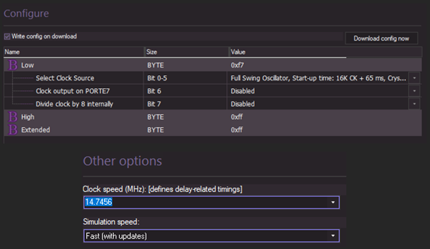

I switched to the AVR chipset. Do you have any material for me to reference on how to set the oscillator? This is the board i am using https://www.bipom.com/products/us/851677.html. It has a CS10-14.7456MABJTR crystal installed on the board. Here are more documents for this board https://www.bipom.com/web_documents/851677.html. Thank you

I have noticed you have set the clock within project options for 8MHz and you have stated the crystal is 14.756 MHz
So you could change the clock to 14.756, then try again.
If still not working then you can try the suggested tests.
