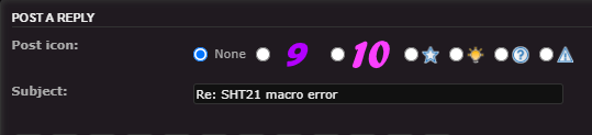

Hello, What version of flowcode are you using?
When you start a new topic can you use either the 9 or 10 post icon please.
