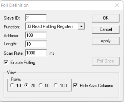

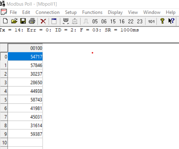

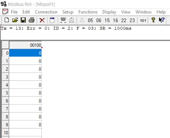

I tried and played with your version of the modbus_Tester. I am having issues with it. It shows all zeros in the modbus poll program. It does connect as I do not get a connection error. Can I set the defaults as decisions? For example if rx does not equal one then set register 105 to value 113? I tried moving it to the decision component, but I would get errors on the modbuss poll progran.
Why is it when I power cycle I get random values?
The getLastIncoming. I am unsure of how it is supposed to work. Does it serve as a diagnostic tool?
Sorry for all the questions. I really want to become more familiar with using modbus with Flowcode. I really appreciate your help! I have attached images below.

- poll definition

- Modbus poll
- MicrosoftTeams-image (2).png (41.79 KiB) Viewed 5402 times
- After power cycling
- MicrosoftTeams-image (3).png (50.89 KiB) Viewed 5402 times

If you read a variable before you write it then it will contain random uninitialised data. Always a good idea to write before you read. Before the main loop you could set all the initial register values so they are in a known state.Why is it when I power cycle I get random values?

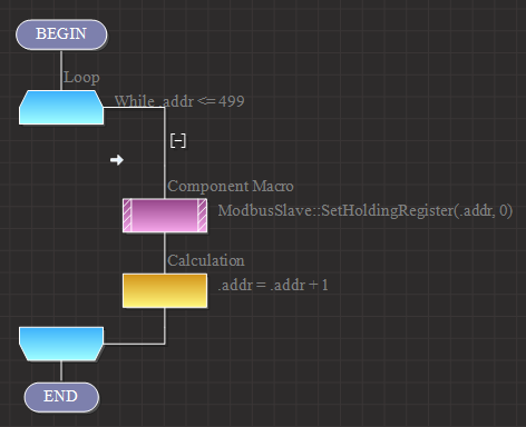

I made a macro that has while loop that initialized the Modbus holding reg. (see below) I then put this macro right after all of the initialize components. This worked for me. I do not understand why? The examples shown on the Flowcode Wiki don't set their modbusslave:setholdingregister registers to 0. Hope this helps someone. Any other tips or tricks with modbus slave holding reg would be appreciated.
addr = 0- Attachments
