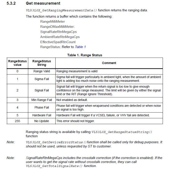

After checking the VL53L0X component and C code, it seams that RangeStatus and others below not used too
RangeMilliMeter
RangeDMaxMilliMeter
SignalRateRtnMegaCps
AmbientRateRtnMegaCps
EffectiveSpadRtnCount
Rangestatus is used to check if the measurement is valid or not .
it's a very important to know if value can be used or not and also because there is "radar aliasing".
Basically the light from flash N comes back after flash N+1, and an object at a far distance, looks near. So if rangeStatus is equal to 4 mean that measure is wrong.
1 - Could you add a component Macro to be able to read the range status register after a read distance and add it in a variable
like this, programmer could be able to use it or not
RangeStatus is from VL53L0X_GetRangingMeasurementData() . (may be register 0x0014 but not sure for RangeSatus )

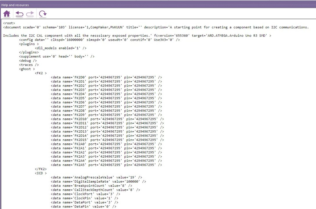

on help, component source project can not be downloaded.
comp download result.jpg (121.35 KiB) Viewed 6421 times

I didn't have much success - reading the register at 0x14 seemed to consistently return the same value (91) - even with something placed on the sensor?
The documentation for the chip isn't great - but I had a quick look at the API code. Some more digging needed.

Try saving the source file with a .fcfx extension
vl53l0x component.fcfx
(125.37 KiB) Downloaded 487 times

Hi Martin,
I did some test and read register from 0x14 to 0x1F, just after a measure
0x14 return 91,33,49,65, 79, 95, etc... this depend of the status result.
Then need to make the calculation:
RangeStatus = RangeStatus >> 6 //RangeStatus is the return value when read register 0x14 just after a measure
-when 0x14 returne value is 91 , after calculation the result is 11 --> Range complete (measure is ok)
-when 0x14 returne value is 33 , after calculation the result is 4 --> No Target
etc...
Do you know what are register 0x15 who return always 6, 0x18 and 0x19 ?
see excel file on PM.
do not ask me how I found these registers and how to calculate, It take so long search and time !!!! :)

Well - finally got the range status to display some meaningful values (okay 91 was meaningful - reading okay!)
So - embarrassingly - the sensor was picking up on the wires I'd used - the field of view and path of the jumpers just gave a enough of reflection... It first 'dawned' on me when I noticed that the values didn't change much when I moved the sensor to point at different locations (and it was giving the same readings in the FC component, my own code and the Adafruit component....).
So - one lesson learnt (maybe) and the sensor returning meaningful values (in my defence it was good at short ranges !)
So - I modified the component to read rangeStatus - and this worked well :-) (Reading it from 0x14)
VL53L0X_GetRangingMeasurementData - is a complex function (and it uses a fair few 'support' functions too...) - but it is doable.
The first step is to read all the registers into a 'temporary' data structure (an array would do here) - and then work out from there.
