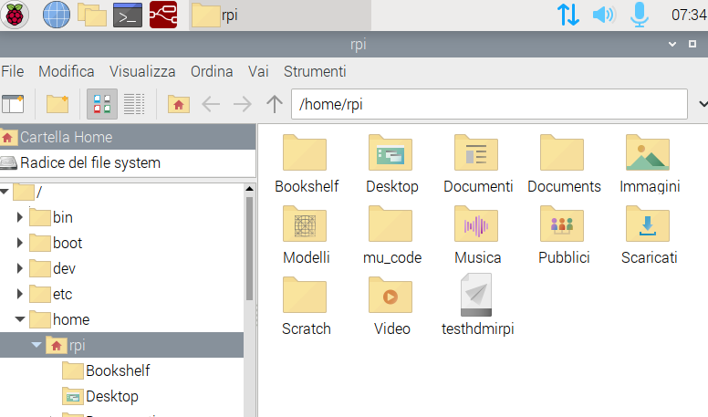

flowcode creates a file without extension using sudo nano opens the file but doesn't run it if I want to start it without flowcode how should I do it? Thank you
- rpi.PNG (63.78 KiB) Viewed 13533 times
