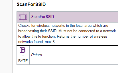

I am using an ESP32_wroom_32 for a Wifi-connected project.
The function ScanForSSID reports the WiFi networks visible at the location, so you can select the one you want to connect to.
Unfortunately, it only reports the first 8 networks it sees.
In my location, there are currently 18 (!) networks visible, and only 8 are reported.
It's a toss-up if the network I need is within the first 8, depending on momentary signal strength I guess.
So this is a show stopper for my project.
Is it a big deal to increase the number of reported networks, like to 256, to be future-proof?

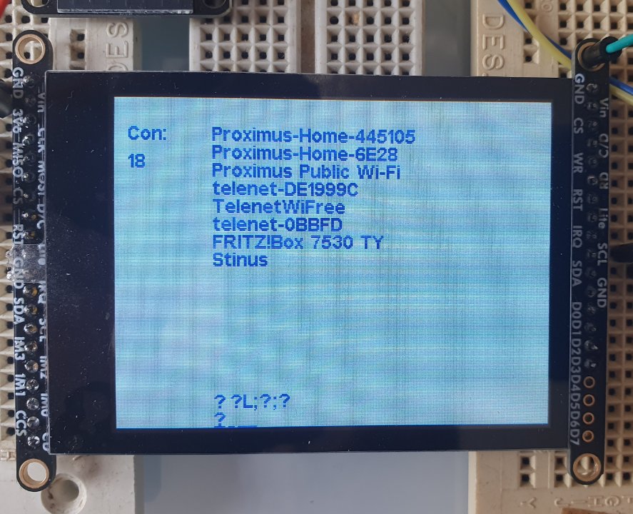

Edit: the number of networks reported is correct, and the correct number of names can be displayed, but only the first 8 have a meaningful string, the remaining are either empty or show gibberish. See attached with 18 detected networks.

The problem with increasing the max number to 256 is that there is a RAM usage hit for each additional SSID slot that is created.
If you want to increase the max count yourself then you can do so by looking at the ESP_CAL_WIFI.c file here using a text editor.
v9
C:\ProgramData\MatrixTSL\FlowcodeV9\CAL\ESP
v10
C:\ProgramData\MatrixTSL\FlowcodeV10\CAL\ESP
Copy and paste the path into your Windows file explorer to get to the directory.
Inside the file look for this line, around line 70.
#define WIFI_SCAN_LIST_MAX 8
Then change to suit your needs, e.g.
#define WIFI_SCAN_LIST_MAX 30
Save the file and then recompile and hopefully it will work as expected now.
I'll investigate and see if we can increase the stock amount a bit without having too much of an impact on existing projects.

Set it to 32 and all is fine.
Now that people get home from work I'm flooded with no less than 23 active networks.
Next is to figger out to make a scrollable list and how to select from it.
