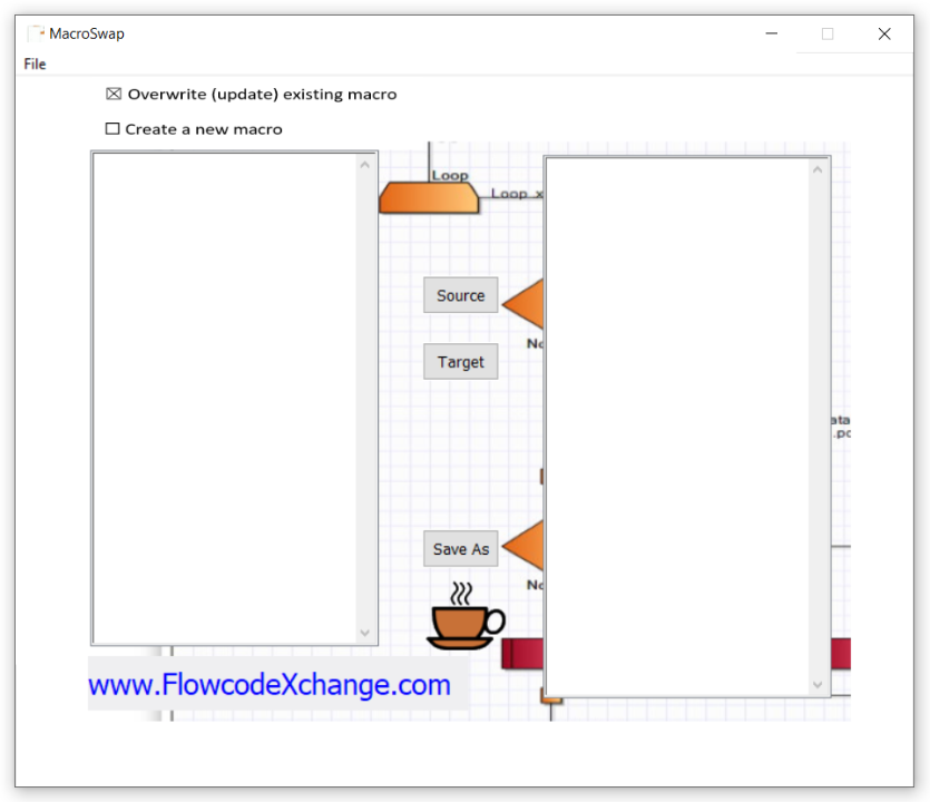

It works perfect! Please more like this.
I think about to use it for update some of my macros.
What about a to choose overwrite or new macro.
Please have a look in the pictures

My thought on this was a dialog with overwrite / rename (user / auto) or cancel..
Indeed it was when I added the check to see if the macro existed in the target FC that I made the mistake
I'd pulled it and thought I'd upload to see if anyone thought it was useful...
But - I'm open to suggestions. Auto overwrite/rename??

Downloaded and tested again. Works fine now in both overwriting and creating a new file.
If the Macro already existed then you would see it in the RH window, or not, so perhaps if it already exists a prompt to overwrite / rename would help prevent accidentally overwriting something unintentionally.

Thanks - at present it doesn't overwrite the macro - just adds it.. Not sure how FC handles two macros with the same name?
Will have a play with the dialog - see if I can get that to work satisfactorily...
