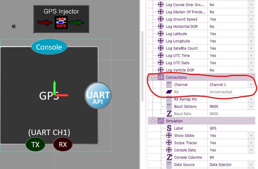

Component: GPS1 : I cannot in RX but get the message Unconnected
Look here:
Compiler Messages.pdf
(73.85 KiB) Downloaded 626 times
