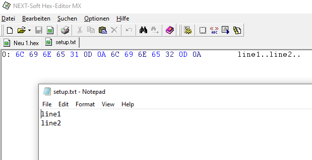

How the setup.txt demo-file look like.

setup.txt
(14 Bytes) Downloaded 817 times
