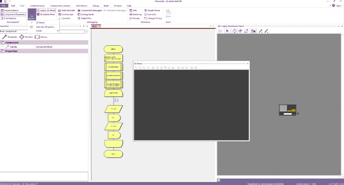

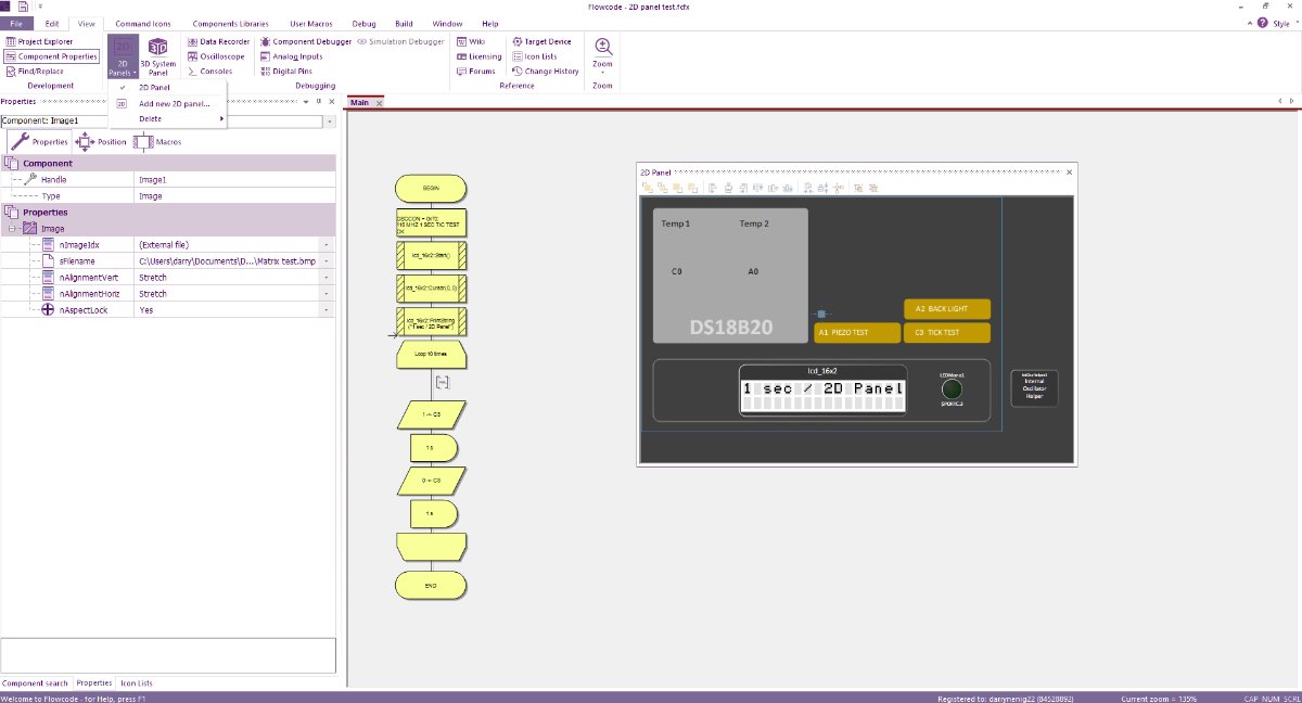

I have used it to create a flat v5 style fixed basic not resizable project. added a 2D component say LCD generic. Then saved the project and closed. then opened the same project again and all the items that was added to the 2D panel are missing, I have a blank 2D panel and the 2D legacy dashboard panel now has the components and missing the background.

Simple test project attached and the before and after grab shots.
Created a simple tic test project on the 2D panel with creation-image as background locked aspect and position. Component IntOscHelper1 and 2D generic LCD dropped into and arranged on the 2D panel.
3D system panel disabled in global and the legacy 2D panel not used.
saved project and when re opened the 2D panel is blank and all moved over to the 2D legacy dashboard panel.

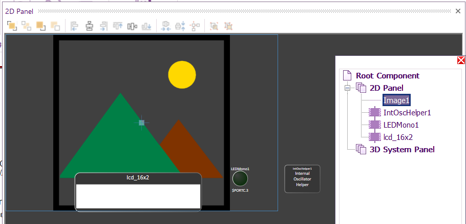

I've opened your project in v10 and it loads correctly for me, although I do not have the image file so it shows a placeholder instead. Here's what I see, with the list of components: I suggest you ensure you are using the latest v10 version (v10.0.4.33) and are fully up-to-date with library file updates. Then close all instances of Flowcode down and reload a single instance and try opening your file.
Also, does the attached file open correctly for you? If so, and the files you create are still misbehaving, then maybe start a project with just a single component and see if that works ok.
And if you are still experiencing the issue, is there anything unusual about your Windows setup? I have never seen the behaviour you describe. And we have a lot of users of v10 and I would expect this to have been reported previously.

So reinstalled v10 and loaded the simple panel test and the 2D panel shows all components and the image correctly. so went to global settings to refine the GUI and setup my scheme and ticked the disable the 3D system panel. Its this that causes the 2d panel to be blank when re loading the project.

That's definitely a bug and I will fix it at some point, but please leave that unchecked as a workaround until a fix is available.
