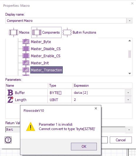

Not sure if a bug or me being stupid (my money is on the latter).
Using the CAL:SPI component I have an option for Master_Transaction.
It has parameters for Buffer and Length however irrespective of what / how / type I try and enter a variable/value for buffer I always get an error.
What is it expecting to see? I've tried bytes / integers / unsigned integers / arrays etc but still the same error. The above is just an example of the error.

Doesn't need the brackets and size for buffer....
If does need to be an array of bytes though.

Thanks Martin
I guess the brackets in the "Type" threw me (or at least I'm sticking to that excuse <s>)
