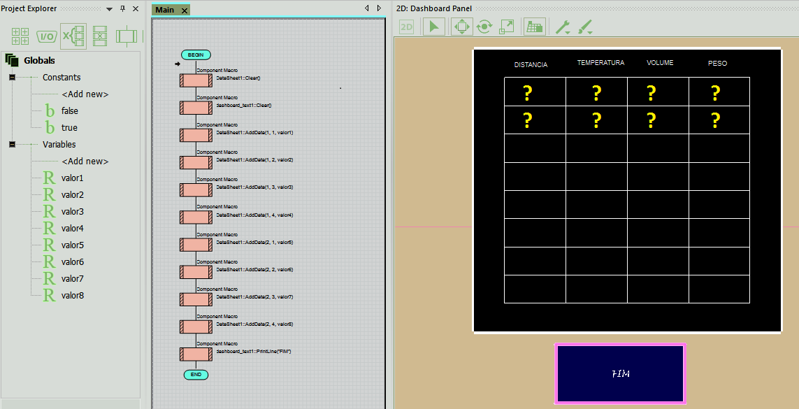

Why can´t I make the DATA (here, 8 of then) appear in the DataSheet component ?
The component seems to be so intuitive.
What´s wrong here ?
Any clue will
be welcome.
Thanks.
"DataSheet" component - didn´t display DATA
- Teste com Datasheet.fcfx
- (17.71 KiB) Downloaded 571 times
- (view online)
- DataSheet Test.PNG (94.2 KiB) Viewed 14409 times

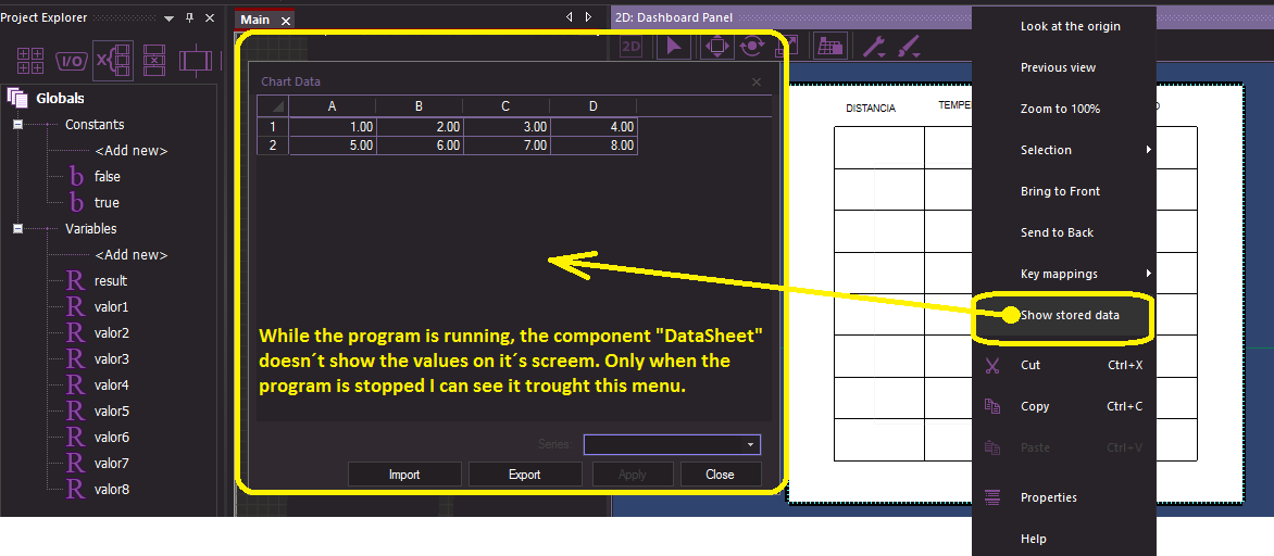

As mentioned in the previous post, the component "DataSheet" doesn´t show the values previously stored, directly in its screem, even with the properties Appearance/Interactive and Appearance/Visible set to "yes".
Only when the program is stopped I could see a fixed "Chart Data" window showing these values.

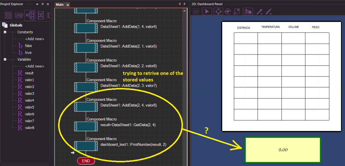

If the variables are actually being recorded, I though print one of them (for example: result = valor8 = 8) stored at row=2 & column=4,
with the "GetData(row,column)" command. But surprisingly I just got the value 0.00.
Do I dealing with this component in a correct manner ? I read the Help/Wiki and
I couldn´t find more details or a example, to try overcome these issues. Thanks.

- Data visualization issue.PNG (66.93 KiB) Viewed 14393 times
- GetData issue.PNG (216.69 KiB) Viewed 14393 times

You should be able to view the stored data during simulation by right-clicking and selecting "show stored data". This was added in 9.3 I believe and so please make sure you are running that version.
But there is a problem and the current available version of the datasheet component is not the most recent. I will ask to have this updated.

Hi. In fact I can view the stored data by right-click and selecting "Show Stored Data" B U T only when the simulation is complete.
I can´t see the values being updated at the Datasheet table, in real time. And that would be very nice to visualize.
I´ve checked, and I´m at v.9.3.0.35 (Standard Version). Will there even be a new version of Datasheet Component ?

You should be able to right-click and select "Show stored data" during simulation. I've just tested it with your project and it is working fine when I step through the project and select that menu item at various points in the program execution. It also works if I add a "while 1" loop at the end and run at full speed. The menu is available and the stored data can be shown. This is with the current v9.3.0.35.
If I misunderstand and you are wanting the values to be displayed automatically on your panel without needing to select that menu then this cannot be done. You will need to write your own code to either display the values on the console or onto a panel text control.
