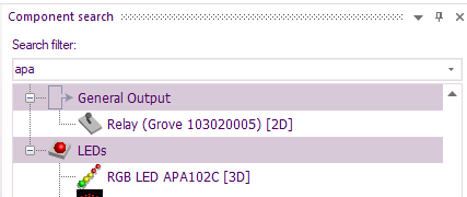

You are using the APA102C component source, which is not intended to be used for compiling to embedded devices.
To get full use of simulation, you should be using the component itself. I Would recommend starting again but using the actual component.
Then get the simulation working first, then send to the RPI.

It looks like you have started with the component source project. Thats probably ok but there's probably a lot in there that you won't be needing for you're embedded project. Also you don't get the simulation. Aha I see Martin beat me to it here.
I've modified your project so it's now using the APA102 component rather then the source code so you can simulate the LEDs.
