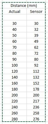

Following up on the FC component now having a setting for short / long range I recreated a test from above. Again using "makerbeam" I created a rail and moved the sensor / taget appart over a distance of 280mm (limit of my setup) and set sensor to short range.
Again, nothing fancy, just averaging 200 readings and displaying. This was only a quick test so each actual measurement may be out by no more than +/-3mm at most.
As you can see there is consistancy in reading up to ~160mm (with an error of about 8 to 11mm) which is far better than in my previous test above. With my accuracy of only 2 or 3mm this does translate quite well in terms of repeatibility.
From 180 out to 280mm this error reduces significantly. So much so that I intend to do more accurate tests out to two metres when I get the chance. Of course my zombie will again be the target for that
