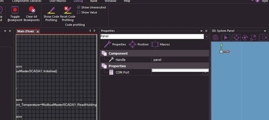

Afternoon,
When selecting the com port to view the available comp ports you just see a white bar.
You cannot see the available ports

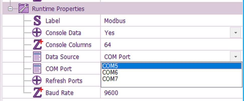

Hi Ben,
showing correctly now, thank you
