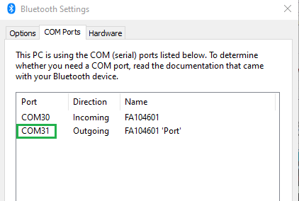

2. determine the correct COM port to use by entering within the windows search box
rundll32.exe shell32.dll,Control_RunDLL bthprops.cpl,,2
then press Enter key
3. Make a note of the COM that the Direction shows Outgoing
4. Open ProximityAlarm_v10.fcsx, within properties of FormulaAllCodeAPI1, set the COM port to the same as Outgoing.
In my case its 31
5. Select Debug > Run THe Blue LEDshould now be solid.
