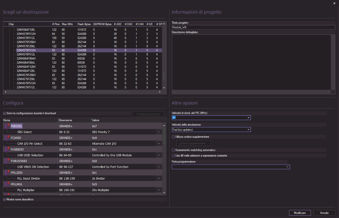

With the PIC32MX575F512H pics I inserted the internal CAN control but as you save and exit flowcode the options disappear,
and furthermore if I enter can1:initialize the microcontroller crashes.
How can I solve this problem
Thank you very much

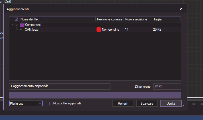

Thanks, this morning I did the procedure and when I opened flocode an update appeared, could it already be the correction of the problem? or do I keep the file you sent me replaced?
Thank you

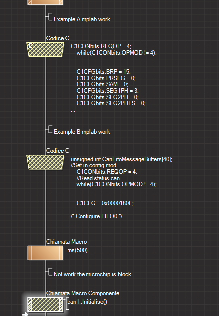

Good morning, I'm doing a project with canbus, when I insert can initialise the microcontroller freezes, but if I insert the parameters I put in mplab it works but not correctly,
in mplab however it works well, this is just an example of a larger project but with flowcode I can't configure the canbus. I attach the example project.
Thank you
Thank you
